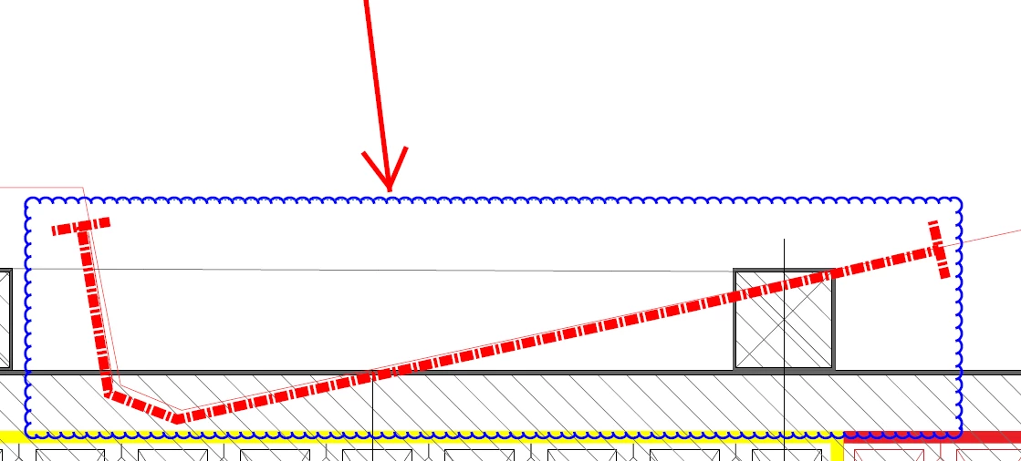

August 4, 2022
Hello
I would like to make blue colored cloud arc size to be increased. As you can see from the drawing arc size is so small.
Thanks.

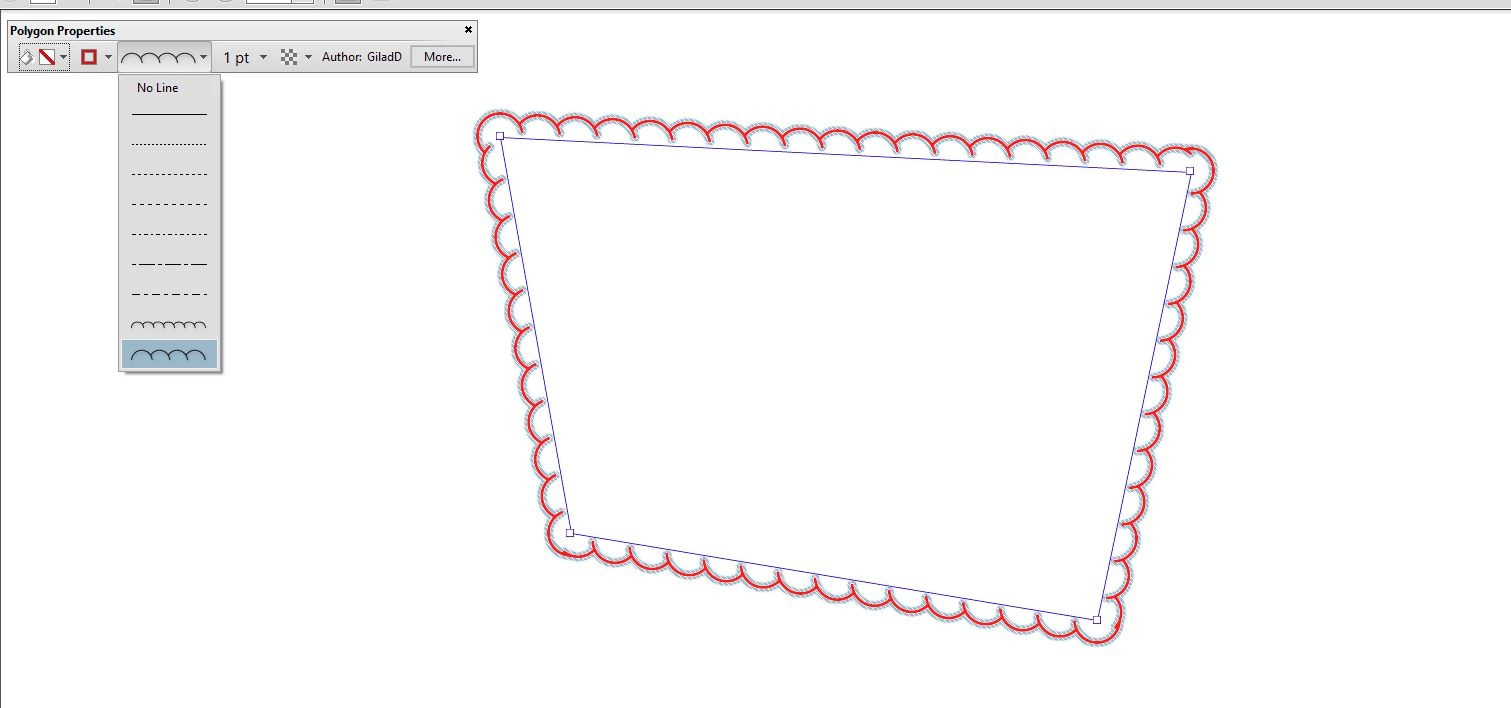

try67
August 4, 2022
Click the comment and press Ctrl+E. A floating properties toolbar will appear, where one of the options is the style of the line. There you can change it to a bigger arc size:
It can also be changed using a script, if necessary.
Once changed, right-click the comment and select Make Current Properties Default, and any new comment of that type you create will have that setting already selected.
