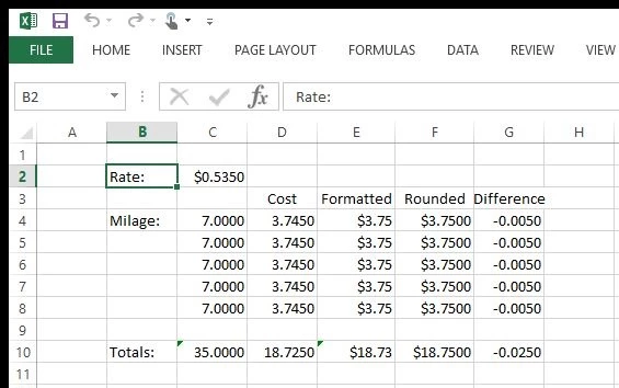

Correct answer gkaiseril
Acrobat and Excel behave in a very similar manner for this type of calculation.
Without any formatting or rounding 7 * 0.535 is displayed as 3.7450 the total of 5 iterations is 18.725.
Formatted to 2 decimal places the displayed value is 3.75 the total of 5 iterations is 18.73.
Individual result values rounded to 2 decimal places the displayed total is 3.75 the total of 5 iterations is 18.75.
When dealing with financial reports or government forms the result of each calculation should be rounded to the required number of decimal places for the report or form.
Rounding Example in PDF and Excel
Since Acrobat does not include a rounding function, a user written rounding function has been added as a document level function to the PDF. This function was adapted form a PDF rounding examples developed by D.P. Story.
Most individuals when computing this type of problem subconsciously round the individual results to 2 decimal places, but computers do not.

Miileage 0.535000
Error
7.0000003.74503.75-0.0050
18.725018.75-0.0250

Result of 7 * 0.535 is 3.745    formatted as 3.75
Result of 5 * 3.745 is 18.725  formatted as 18.73
