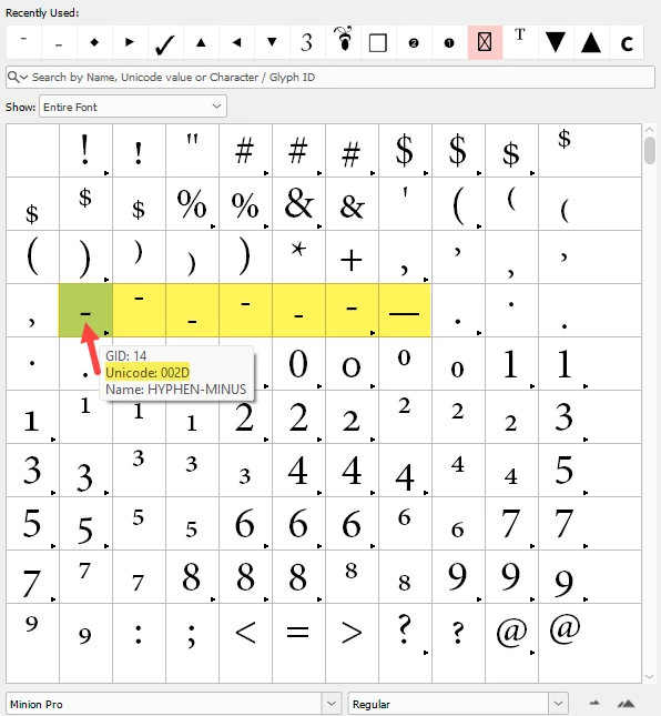

Hi Charlotte,
GID = Glyph ID.
In your case, different variations of the hyphen (U+002D) were used in the document you described. All were hyphens, but with different variations / GIDs. The sample shown below are the hyphen variations in the Minion Pro font. All of the yellow highlighted glyphs are the same Unicode 002D, but with different GIDs.
Using alternate variations (same Unicode but different GID) is dicey because not all technologies can handle the variations. Also, not all fonts have variations — or the same variations — as other fonts.
We avoid using glyph variations in our files because there are too many cases where they fail from one program to another, or from one publishing technology to another (like PDF, EPUB, and HTML).
Suggestions:
  • For the bullets you described: we recommend setting a bullet Paragraph Style that uses an en-dash (U+2013)  that is available on all fonts and works across all technologies. It should be fail-proof for your project.
  • Those old projects appear to have used outdated methods and fonts, and also have some inaccurate construction in them. Ditch them because there are too many crazy things in them that will just continue to fail, and waste your time. Rescue the text by selecting the stories and File / Export to RTF.  The resulting word processing file will retain the styles, which you can either remove or keep/revise. Your choice. If these were my files, I'd bring the RTFs into Word and strip out all formatting to clean up the code, and replace any odd characters with the correct Unicode glyph (Word has a nice glyphs pallete that works like InDesign's).
Hope this helps. Best to you!
