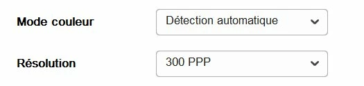

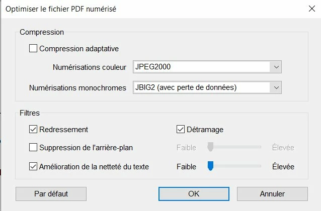

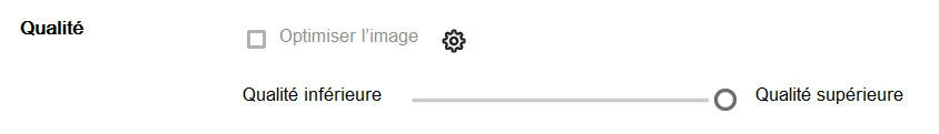

January 14, 2024
Hi Gary,
My scanner is a multi function HP scanner, that make scan and print.
What I have done is to manage completely the scan with Acrobat Pro by using the function "create a PDF" and choosing "Scanner" in the menu. I give you my scan settings from Acrobat Pro :
1) Color mode on "Automatic", and resolution on 300 PPI (it is the maximum of PPI shown by Acrobat Pro, so I suppose my scanner is limited to 300 PPI) :
2) Optimization of the scanned PDF (I have no adaptative compression and no automatic background removing + descreening + improving text sharpness) :
3) Quality at the maximum :
So, I don't make my scans in TIFF with histogram, then in PDF : I make all my scans directly in PDF by using Acrobat Pro (Create PDF function), and I simply manually remove the background on each page with Acrobat Pro on the created PDF.
You are talking about "Levels" : where can I find it (is it in the scanner software) ? In my case, with Acrobat Pro, what could I do "at the creation of the scan" ?

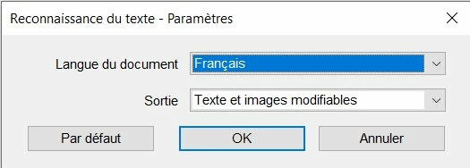

January 13, 2024
Hi Gary,
Thank you.
According to your advices, I have done :
1) First I have set Acrobat Pro on this setting for the scan (OCR setting on "Text and image") :
2) As I cannot destroy the book binding, I have put the book the most flat on the scanner.
3) After scan, in Acrobat Pro, I have cropped each page around the text. Then I have removed the background on each page.
4) And I have exported it in a Word Document.
Result : it seems to be far better than before (less errors in the Word document).
