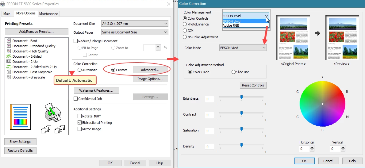

It is an Epson Epson Manual PDF
In the documentation "Color Correction" is mentioned, but not where to find it.
Just now I -finally- found it. By default 'Color Correction' is set to 'Automatic'.
Users can go into 'Custom' setting and change things to their liking. There are a number of options.

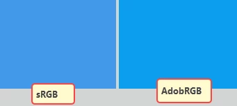

It is currently set to D65 (sRGB).
It can also be set to AdobeRGB
OTOH, if my memory serves me well, I once read that for 'normal' non-professional photos sRGB is quite sufficient.
In Windows 10 settings > display I can select the monitor color profile HP AdobeRGB, which I can also do in Photoshop and can also set in the Advanced printer settings. This way, I think all is set using the same.
Maybe that would be the best solution?
At the end of the day I set everything to AdobeRGB
Windows 10 x64 Settings > Display  to HP AdobeRGB .icc
The Epson printer to AdobeRGB (Printer does not support sRGB)
The monitor, Acrobat and Photoshop as well.
All is set the same way now, I let it rest.
AdobeRGB show somewhat different colours than sRGB though.

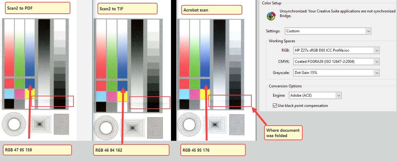

Windows is set to the colour space set by my monitor (HP Dreamcolour)  sRGB
Acrobat is set to the same, of course.
That's done yesterday, while I was writing this post.
Before that no colour space was defined and I did not realize that. I think some 'Generic PnP monitor' was taken, I don't remember exactly, but not the monitor I was using.
That resulted in some blueish colours.

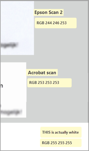

I can scan documents using the native scanner software. In case of documents containing colours (logos, coloured fonts, whatever) the scans are a little blueish. White is not white, but blueish.
This is particularly striking in cases of unfolded documents, i.e. documents that were folded initially, because they had to fit an envelop, or pocket, but unfolded whilst scanning.
The 'folded edges' are much more distinct and are somewhat blueish. Regretfully the scanner software does not offer any settings to improve this.
When scanning using Acrobat - which in fact is using the native scanner software - this is hardly (or not) visible.
White is simply white
I have no explanation as to why Acrobat is able to produce a better scan quality.

As said, the matter is, to a large extend solved. Below after setting the sRGB colour profile, the differences are minor.

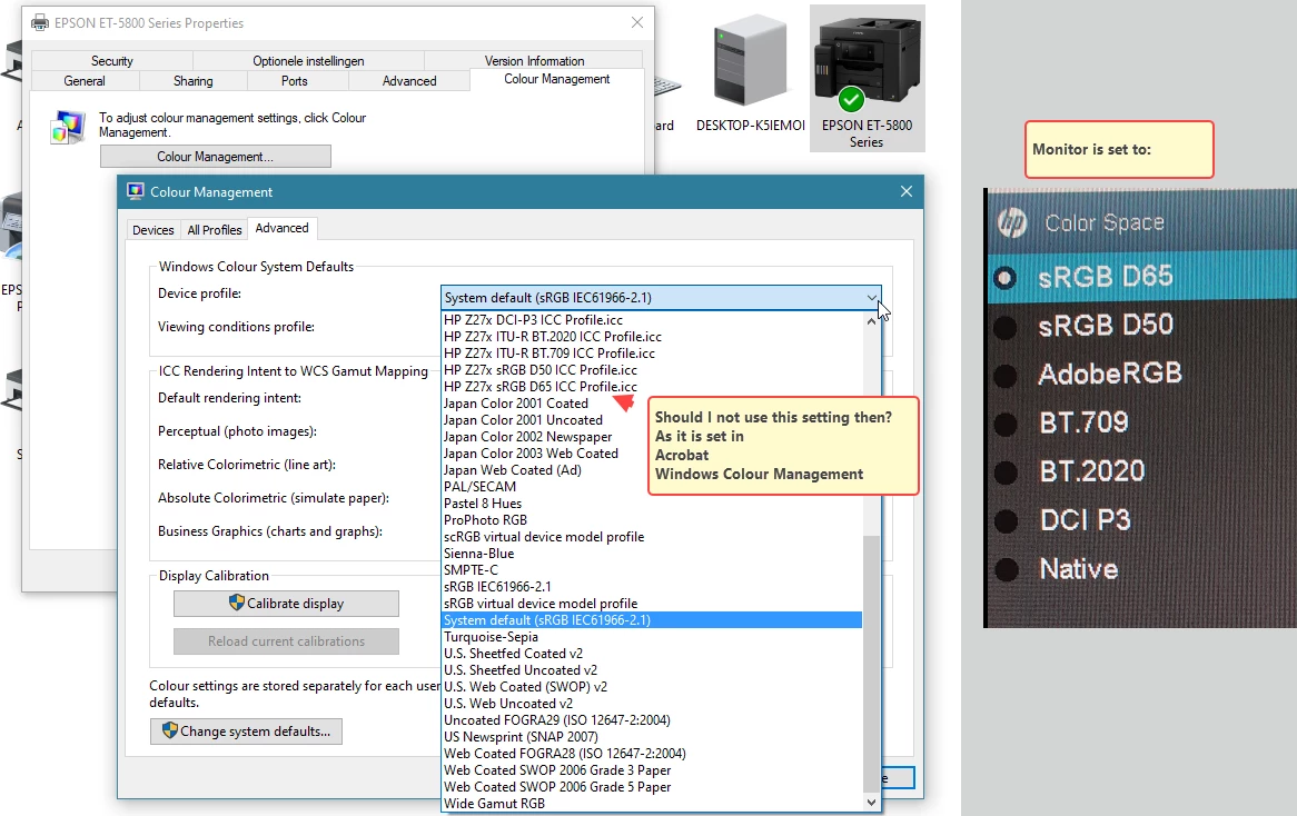

when I go into Start > Control Panel > Hardware and Sound > Devices and Printers
select my printer, then r-click "Printer Properties", select tab Colour Management and click on that button
then select tab "Advanced" - under Device Profile it says System default (sRGB IEC61966-2.1
I wonder, should I not select the monitor profile there, showing up in the dropdown list. So, in that case, ALL is set to this HP Z27x Dreamcolor ICC ?

The color settings you are showing me are for printing; I'm pretty sure they are not for scanning.
