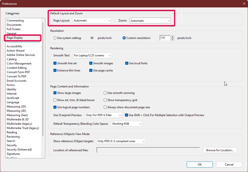

I'd check setting in two places:
Check your Acrobat Preferences, and see what your default is set to for magnification:

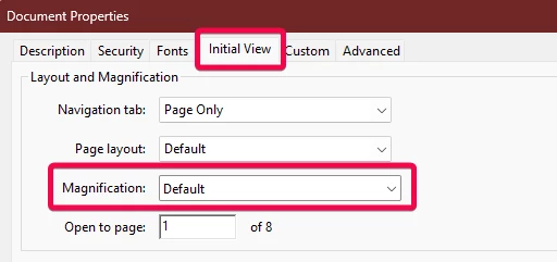

I would also open up one of those scanned PDFs and check the Document Properties/Initial View tab.  Is that 175% baked into one of those settings?
