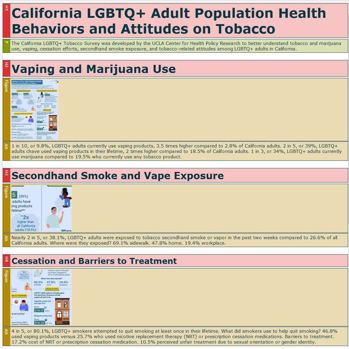

We often hear that Acrobat's read aloud feature isn't a "real" screen reader, and that results should be taken with a grain of salt., which seems a bity weird. But in any case...
When I want to check reading order and don't want to listen to a robot reading to me, I use PAC3's "Screen Reader Preview," which shows you visually what a "real" screen reader sees; strictly following (I think) the order using the tag tree. Below is a screen shot from PAC3's peek at your doc, does it look correct? If so you're probably good, despite what Acrobat's robot voice is telling you.
