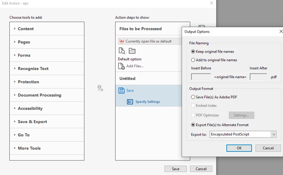

I setup a Action Wizard action in Adobe Acrobat Pro, the purpose is to save the PDF as eps.  I hope open a pdf file , then automatically perform actions, how to do with script?
Correct answer try67
My purpose is to batch process save as eps, rather than write a script for each PDF.
Right. The batch process takes care of opening and closing the file(s) for you. You don't need to do that in the code.
This is all you need to add:
this.saveAs({cPath: this.path.replace(".pdf", ".eps"), cConvID: "com.adobe.acrobat.eps"});

Not possible. A script can't run an Action.
try67
July 1, 2024
You can use a script to perform the same action, though, using the saveAs command, but you can't run it on multiple files, as an Action can.
rui huangAuthor
July 2, 2024
script Acrobat is difficult for me,because it don't like Illustrator , can use "#target illustrator" to executing code. I don't know how to write a javascript to open pdf with Acrobat , then save as eps.
