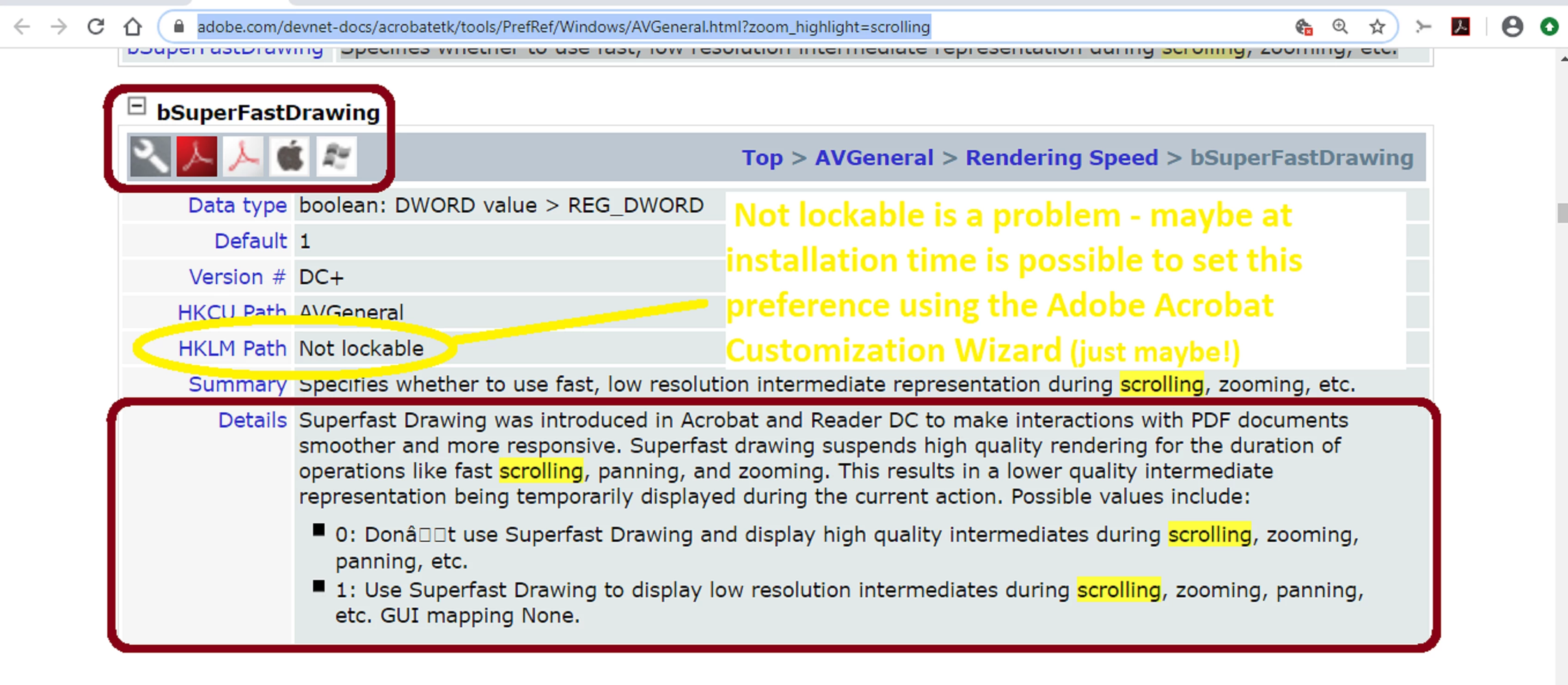

See if this information about a Plist preference can help:
NOTE : my slide says mentions about "Not lockable" meaning that user can modify it. That could be both good and bad depending on the work environment, but it is worth giving it a shot.
Here is the  link to the Adobe Enterprise Toolkit:

this looks a little hairy to me. I wouldn't know how or dare to alter preference code!

May 4, 2020
Yes, I agree.
Sometimes some preferences are just set as default during installation.
I learned that recently from digging more in the Enterprise tool kit.
And the only way to change some of the applications behaviors is through Plist editing and as long that Plist preference is not locked.
Otherwise, only administrators can chamge it (also during installation time of the application), where they pass these preferences as parameters to the setup program.
This is achieved using the Adobe Acrobat Customization Wizard, and in some cases with just a simple few lines of shell scripting using the console.
