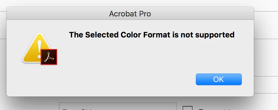

I was suffering from the same issue with an HP LaserJet:
  • image capture to tiff works.
  • Hp Easy Scan works
  • Adobe Acrobat in B&W works
  • scan tool shows preview, but then when scanning in color complains about color format
  1. Go to System Preferences >> printers&scanners and remove the printer.
  2. Go to the HP website to download drivers. The link here happens to be for my printer.. but it may differ for other models (although I doubt it,  the software looks like it's intended for all HP printers).
  3. DO NOT GO with the recommended "HP Smart App". Instead, look under "drivers" and download "Install HP Easy Start".
  4. When running the above it will identify your printer, and prompt you to install the latest HP Smart Software....   AGAIN DO NOT DO THAT...  Instead click on the red X to close the window.  Doing so will open a pop-up giving you the option of  "Skip to Software Download".
  5. Select both "Essential Software" and "HP Easy Scan", and hit Install.  This should finally update your driver correctly.
  6. Run Adobe Acrobat X or whatever, and try to scan (it worked for me).
Yes, all these instructions actually do is update your driver (pretty much the recommendation Adobe gives, but HP makes that VERY VERY hard as they keep pushing you to use the HP Smart app instead).
once again try to route you to the HP Smart App.  Skip and install the old stuff instead:

juanc15542684, did you ever get a solution for this problem?  I'm having the same problem scanning from Adobe Acrobat 11 (in Sierra 10.12.1) from an HP LaserJet Pro MFP 476.  However, I am able to scan color using Sierra's native "Image Capture" app, and save that to a PDF.   So that indicates that Acrobat has a glitch in the Sierra environment.

I'm having same issue using with the Adobe using an HP Scan Jet 3500 f1  on a Mac.
Works fine in text or black and white.
No combonation of settings of JPEG, JPEG2000, etc would work with color.
In color this is the error message:
"The Selected Color Format is not supported"

Hi Lovekesh,
I have the same problem: The Selected Color Format is not supported
Os: MacOS Sierra
Acrobat version: Acrobat Pro DC 2015.020.20039
Scanner details: HP Photosmart 7520
Format: tried several, JPEG, JPEG2000
Image Capture: works fine
Thank you,
Tom
