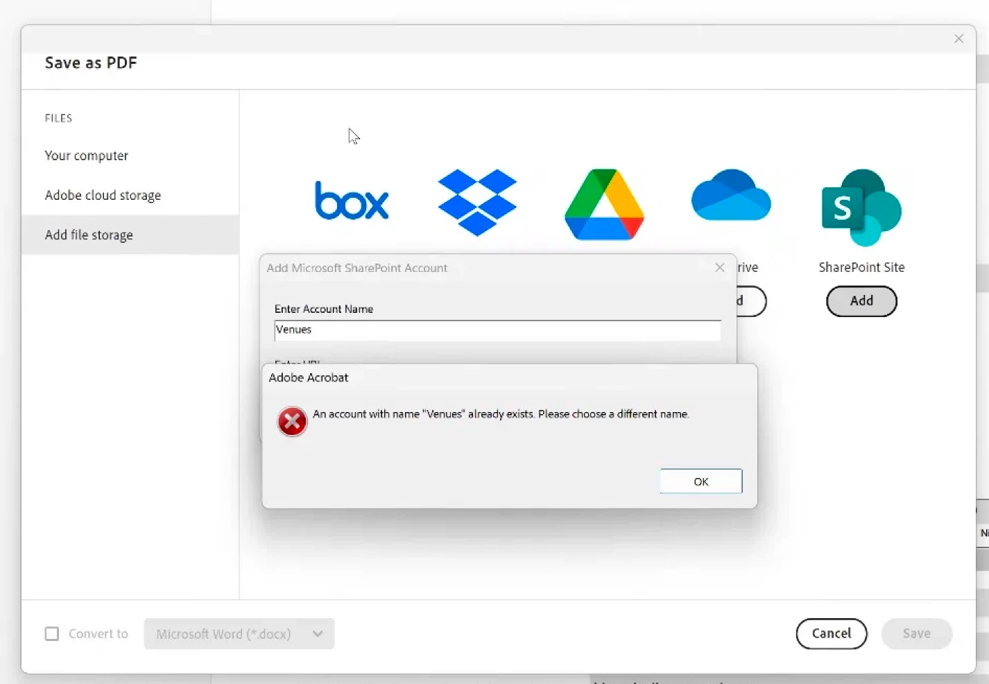

When I try adding an SPO site (I use global admin account and 100% it has acces to the specified SPO site) I get this error.
In the SPO acces is allowed for app not using modern auth.
In the SPO there is an Enterpise App for Adobe Acrobat with admin consent granted.
Please advise what else I should check?

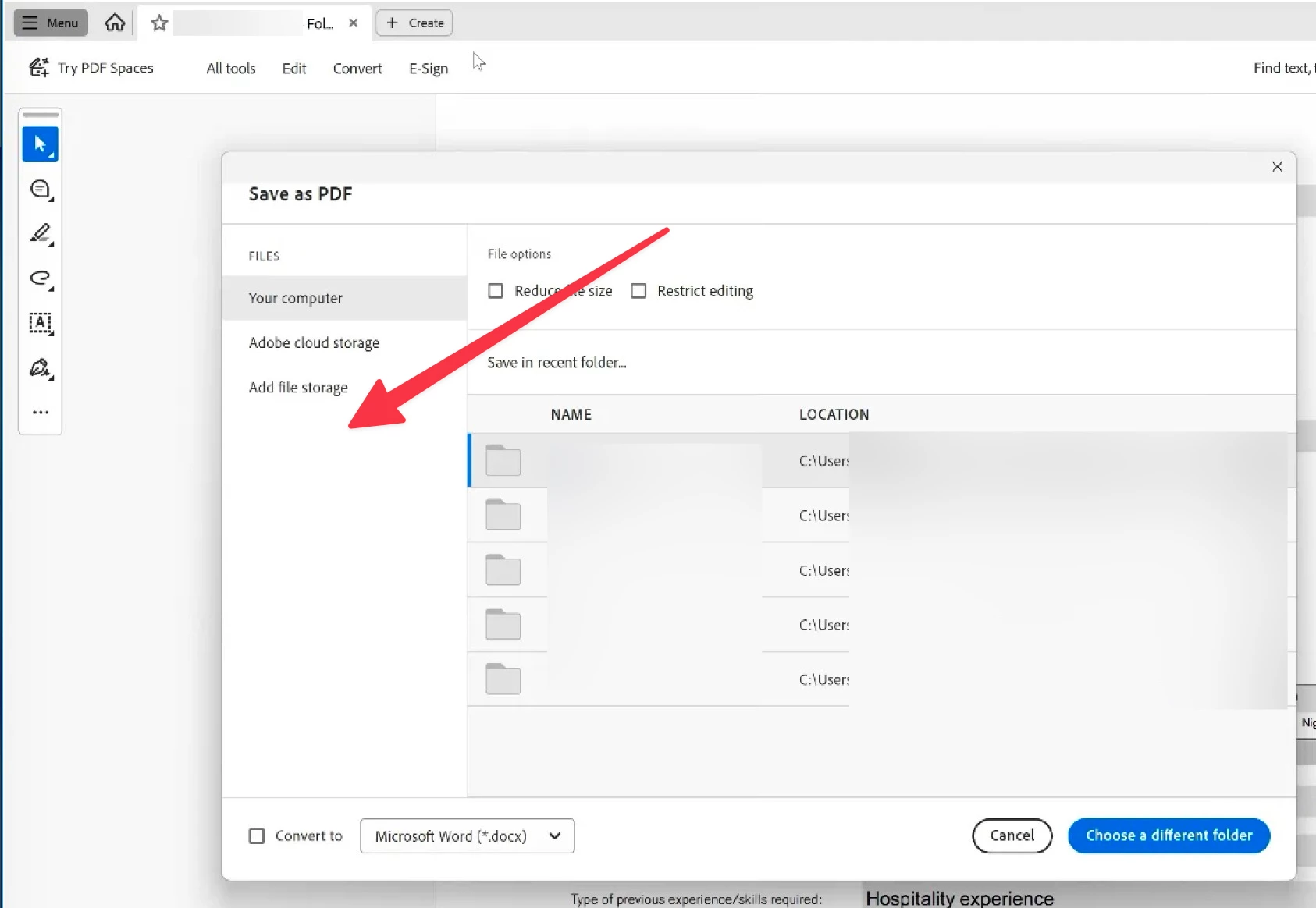

After disabling modern authentication in registry HKLM\SOFTWARE\Policies\Adobe\<product name>\<version>\FeatureLockDown and deleting the followin g directories
rd /s /q %appdata%\Adobe\Acrobat
rd /s /q %appdata%\Adobe\NGL
rd /s /q %localappdata%\Adobe\NGL
rd /s /q %localappdata%\Adobe\Acrobat
rd /s /q %localappdata%\Adobe\AcroCef
rd /s /q %localappdata%low\Adobe\Acrobat
rd /s /q %localappdata%low\Adobe\AcroCef

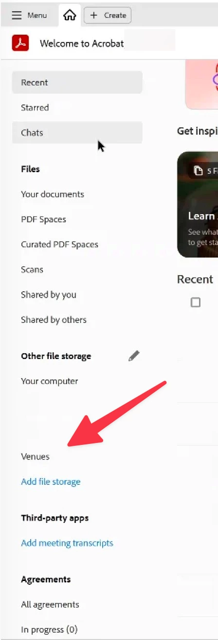

I managed to add SPO site.
However, when a user wants to save a file they see this.
Why it disappears?
Does the user do something wrong?

Hi GL012025 ,
Thank you for sharing the information and the screenshots.
This appears to be odd behaviour. Please confirm whether the file was opened from the local source or saved on a drive. Did you check if this happens with other files?
Please collect the process logs using the diagnostic tool and share the log ID created. Also, share the Acrobat and OS version numbers currently in use. We will get this checked.
