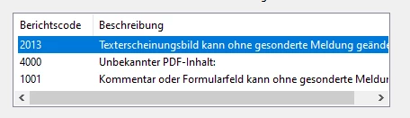

If I click "view signed version" and the report I got some issues (see picture)
Can someone give me a hint/ where I need to look at?

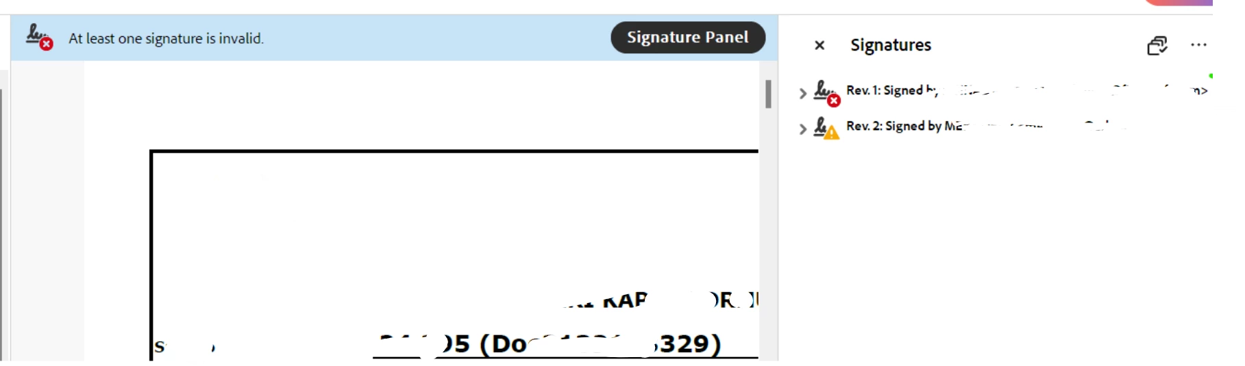

It took a while to understand the root cause because, while all other applications recognized the signatures as valid, Adobe Reader/Acrobat marked all signatures after the first one as invalid and only considered the last signature as valid.

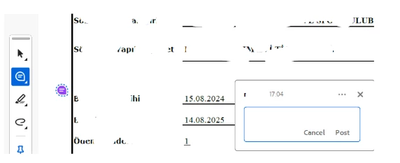

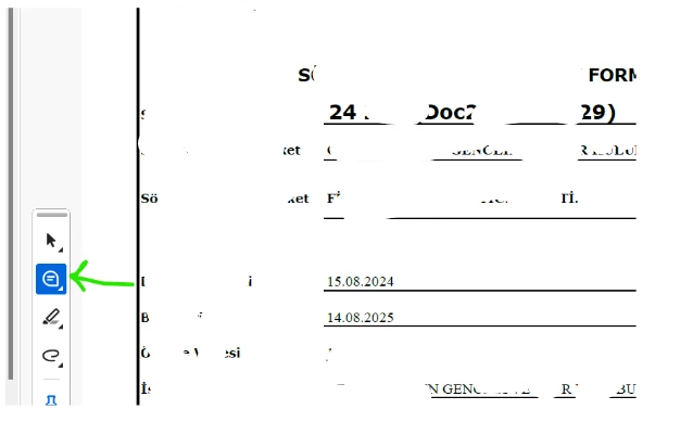

After extensive trial and error, I discovered that this issue occurs when a PDF is generated by merging multiple documents and at least one of those documents contains a comment or annotation.

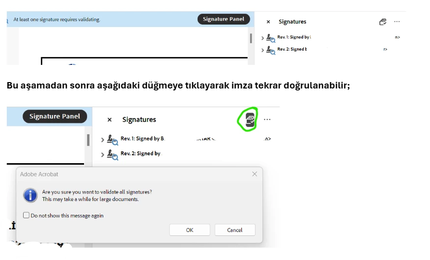

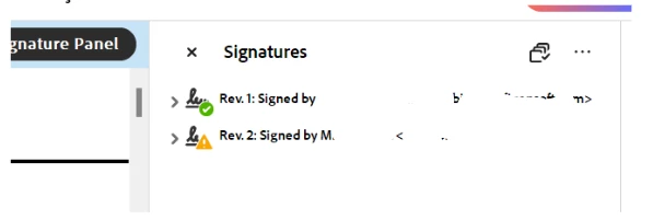

Once I identified the problem, the only workaround I could find was to open the affected PDF (where signatures are shown as invalid), add a comment to a  page, and then cancel it without filling it. Doing so prompts Adobe to revalidate the signatures, after which all signatures appear as valid. However, you must first manually click the Validate button for this to take effect.
I believe this is a bug.
Attached images (error_1, 2, 3, 4, 5)
