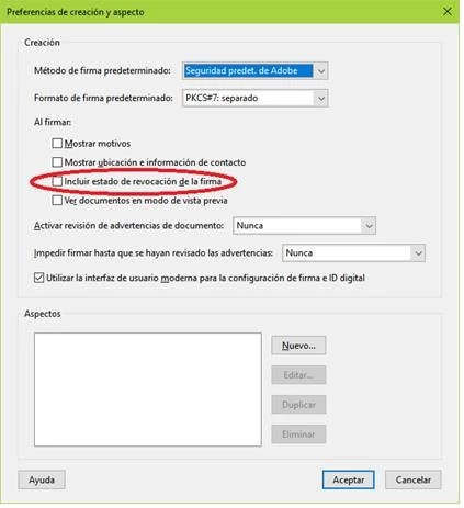

We have problems signing PDF documents when the PKCS # 7 format is established and leaving the "Include signature revocation status" option unchecked as shown in the image.
Indicate that if the option "Include signature revocation status" is checked, then the signature and validation is done correctly, it is also correctly signed if the CAdES format is used instead of the PKCS # 7 format.
