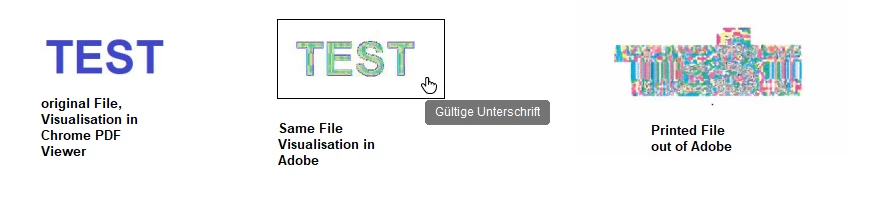

I’ve encountered a rendering issue in the latest release of Adobe Acrobat Reader DC (64-bit, Windows 11, 25.001.20630).
When using qualified electronic signatures (QES) created with Digiseal desktop software, the signature image inside the signed PDF looks blurry, slightly grayish, and less color-accurate in the latest Acrobat Reader DC.
However:
  • In older Acrobat Reader DC  of this year versions (e.g. 25.001.20577,), the same signed PDF displays the signature image perfectly — sharp and color-accurate.
  • In other PDF viewers (Edge, Foxit, Sumatra, etc.), the PDFs also display perfectly.
If i print the file the ourcome is terrible.
I tried a lot with Digiseal to use different images and formats, field sizes, image sizes. Sometimes it gets a little better but nothing works like it did before.
As this is a big deal for me i would welcome any help or insights that could help me out!

Hi there,
Our team has checked the details you shared and found that you are using the 32-bit version of the Acrobat Reader application. They are working on a fix for this issue. We will share the update as soon as we get more information.
As a workaround, you can try using the 64-bit version of the Acrobat Reader application here: https://get.adobe.com/reader/enterprise/  and see if that works for you.

axel_7277Author
August 21, 2025
Hi, thanks for your suggestions. I tested the proposed steps, but unfortunately the issue persists:
  1. Testing with a different digital signature
    I created different signatures that did not work out. The issue still occurs.
  2. Disabling Enhanced Security & Protected Mode
    I turned off both “Enable Protected Mode at startup” and “Enable Enhanced Security” in Preferences and restarted Acrobat.
    → No improvement, the problem remains.
  3. Checking rendering preferences
    I have tested changing the the settings, but the problem also exists across different signature images and formats, and it only affects the latest Acrobat Reader DC builds.
    Since the same PDFs display perfectly in older Acrobat Reader DC versions and in other PDF viewers, this strongly suggests a regression in the current rendering engine rather than a configuration problem on my end (?)
  4. Could you please escalate this issue to the engineering team? It seems specific to how Acrobat now renders signature appearance streams in the newest release.
