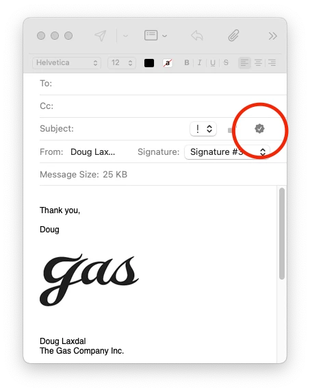

For months now recipients of emails sent from my Mac have gotten the 'unable to verify message signature' notice. I recalled that it started happening around the time that I created a new Adobe Digital ID.  Turns out that all I needed to do was to uncheck the little star shaped blue check box on the far right hand side of a compose email window. Turns out that check box tells mail to use the Adobe signature. Once you check it off it stays checked off. On my co worker's computer they dont have that check box in theire compose window because they don't have an Adobe Digital ID on their computer. Hope this helps!

THANK YOU THANK YOU THANK YOU THANK YOU!!! Solved! I tried to "Remove ID" in Adobe settings (which I would still  like to be able to do), but when I would select the digitial ID and clikc "Remove ID" it did *nothing*. I still don't liek that I can't remove the Adobe digital ID, but mail is fixed at least!
