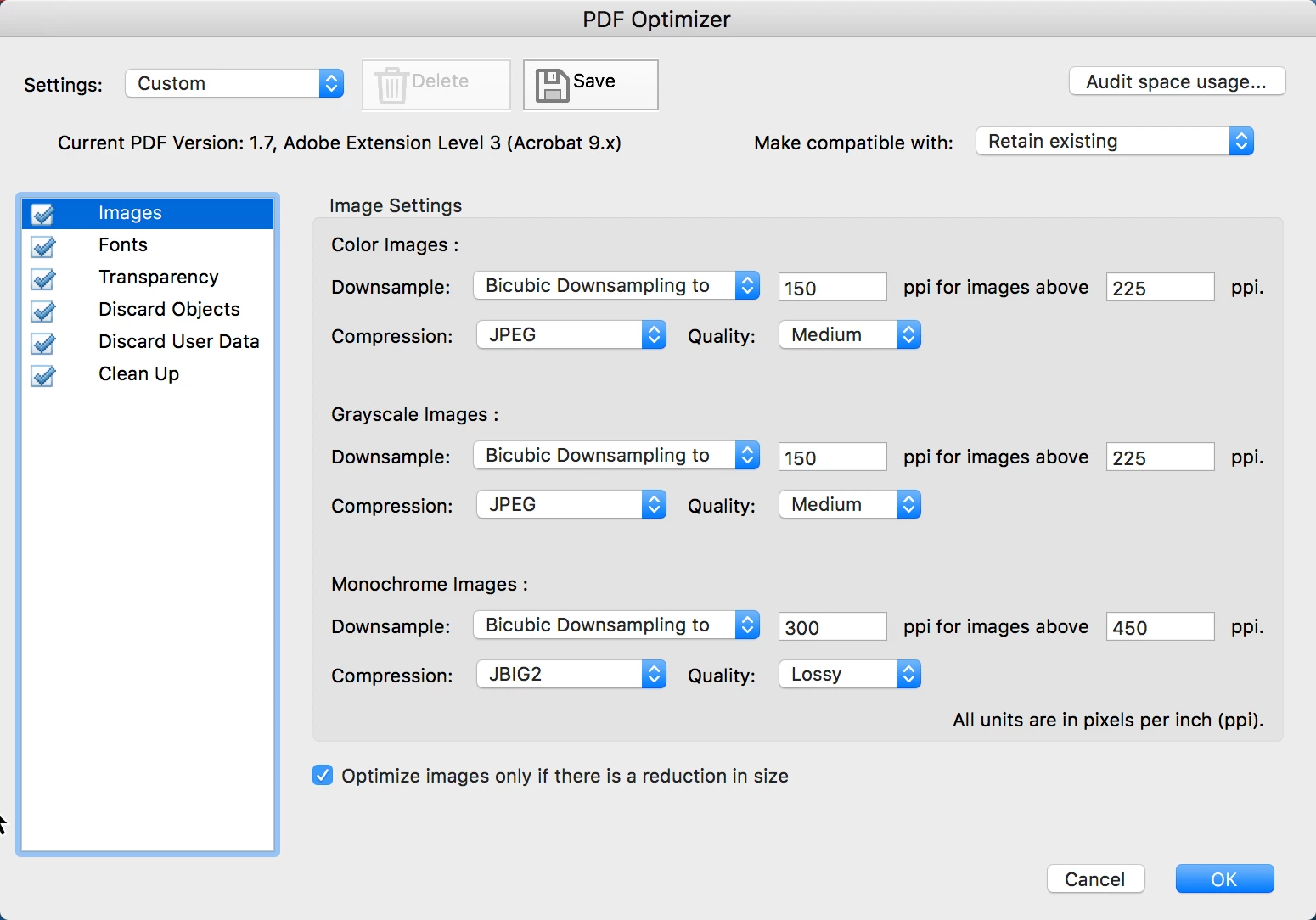

How are you presently creating the PDF and from which application?
You can use Adobe Acrobat DC to reduce the size of the PDF after you've created it:
  1. Open the PDF in Adobe Acrobat DC

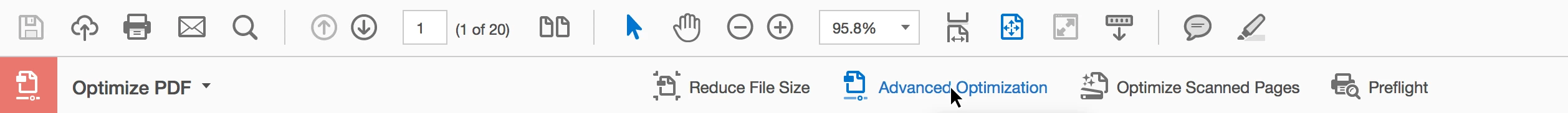

  2. Click Tools tab, and locate Optimize PDF under the Pretext & Standardize category (You can also type 'Optimize' in the search field to quickly locate this toolset). Select Open from the menu.
  3. Click Advanced Optimization in the Optimise PDF toolbar.

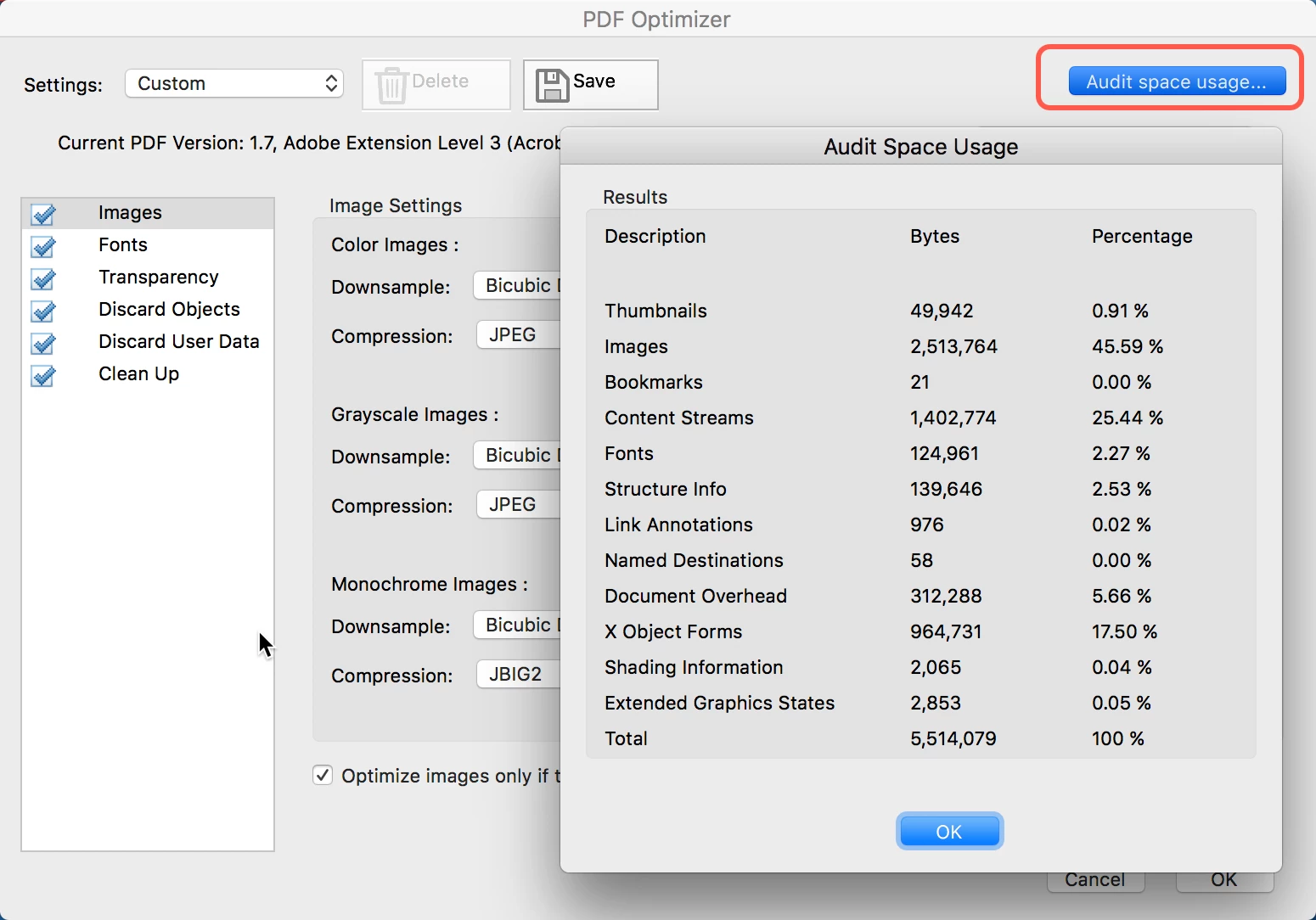

  4. To analyze which elements in the PDF have the biggest impact on the file size, click Audit space usage in the PDF Optimizer dialog box.
  5. Once you've take a note of the Audit Space Usage results. Click OK, and then select for example Images in the PDF Optimizer dialog box, and adjust the image settings, e.g. by reducing the resolution and compression level of the images.
  6. You can go through all the categories on the left, and adjust settings and eventually click OK and save the PDF that is optimised under a different name. (don't overwrite the original file, so you have an option to go back and try other settings).
