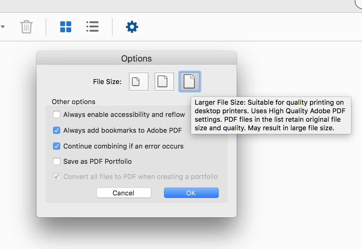

Unfortunately Adobe dumbed down their interface here so you do not really know the dynamics of what's taking place here but if you mouse-over the three options you can at least see "sort of" what's taking place here. In the Combine Files window, if you click on the gear icon you can see the three options. You can see which one you need to correct if you feel you need it.

Right on, I noticed that and performed again the combination process after selecting the third option called "Larger File Size". However, even then the size of the single file was only about 15 MB larger than before when the second option was selected. It still didn't even come close to the total size of the separate PDF files.

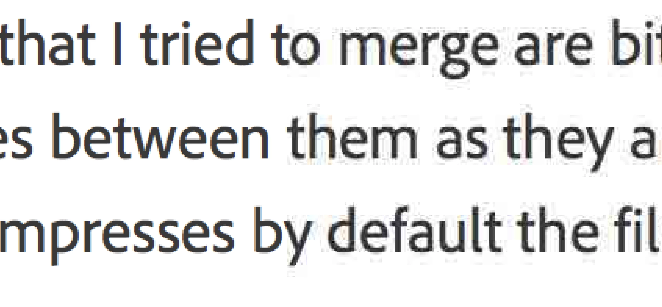

I took a screenshot of your message and did a whopper of jpg compression on it with Photoshop to exaggerate the effect to make my point. Below, on the left is a screenshot taken with a PNG format. [That format is not lossy so the quality will not be affected by subsequent saving.] On the right half is the result of heavy compression.
You can see little flakes of pixels floating around the text.
I mention all this so that you can look at your document and see (1) if you see any of this in your original document and then (2) see if it's any worse or about the same in the combined document. Zoom in to look, please.
My point in all this is that if things zoomed in look about the same, than any loss in storage size is inconsequential to the quality of the output. If there is apparent quality loss, than try again by increasing the final file size.
But keep in mind, if you do not SEE any visible difference between your original scanned documents and the combined document, there's no real need to do this.
