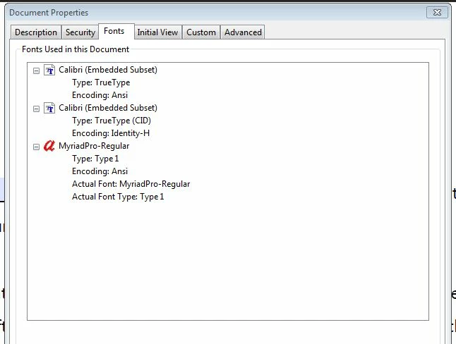

What is the best way to determine that? Here is a screenshot of the Fonts properties for one of them:
Would I be correct in assuming that the Calibri fonts are embedded, but the MyriadPro is not? If that is the case, how do I make them embedded?

The image you posted shows the fonts that are embedded in your document: both Calibri and Myriad Pro. However, the second instance of Calibri indicates that some some of the Calibri characters were encoded differently, and I suspect based on the combo characters you listed, these are glyphs and are what your printer is having trouble processing.
The usual solution for print server issues is to make sure all drivers and firmware are updated.
The answer to your question regarding embedding fonts completely is to change your Adobe pdf print preferences to embed all fonts, not just a subset. This must be done when the pdf is being created initially. You can change font embedding by choosing a joboption like Press Quality that includes full font embedding or by modifying the joboption you are already using. In Windows, you can do this at the time of print by selecting the Advanced button next to the printer selection dropdown and changing settings there, in advance by modifying the printing preferences from your printers menu, or by editing the joboptions in Acrobat Distiller.
