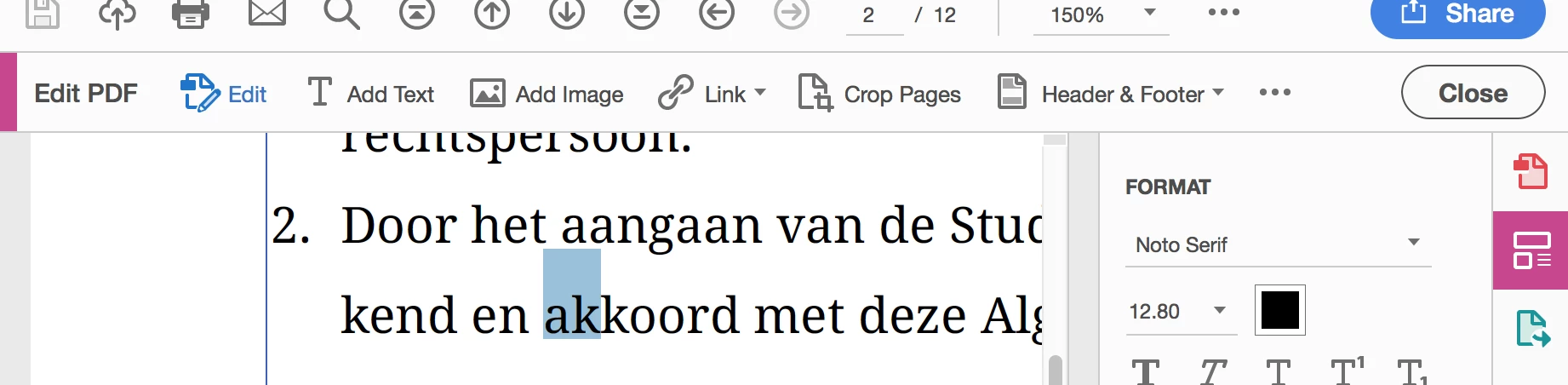

Hi Gary,
Every non-capital "st" combination on the website turns in to this (st) ligature, See image below. I'm using Adobe Acrobat Pro DC, version: 2018..011.20063. I thought about replacing all those ligatures by editing the pdf, but this page is only an example. The actual page is way bigger and undoable to replace one by one. Is there a way Acrobat doesn't convert it to a ligature, but keeps the original "st"?

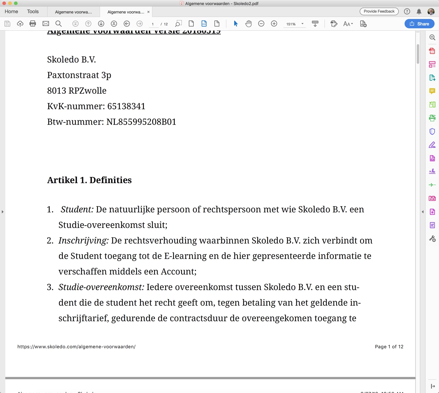

A couple of things and your inquiry shows up a couple of inadequacies of Acrobat Pro. If you do a Find and Replace, Acrobat can only search on whole words not part of words but can do a replace. To get the ability to search on a partial word you need to use the full search capability which can search for two letters, you cannot replace.
On the other hand, when I processed that document you referred to, I did not get any ligature for the "st" combination. This leads me to ask that since this is a document in German, are you converting this document with Acrobat setting for looking for German words? I'd like to send you the document that I have on my computer but unfortunately this website does not allow for PDF documents to be sent. The best I can do is to show you the same page that you show above without any ligatures.
I should add that despite a big search, I could not find out how to manually create the "st" ligature. I'm no a Mac and if you can tell me the secret sauce I'd appreciate! I do not know that not all fonts have this character but even with those that do I cannot create it.
