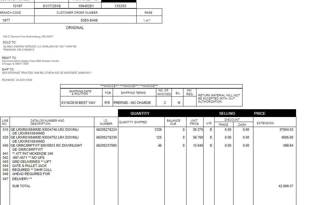

We have Adobe Acrobat DC Update 18-009-20050 and Windows 10 OS Build 16299.192. We receive and print over 50 invoices a day and 2 out of 25 vendors are now view and print with "hieroglyphics" instead of text and numbers. If I convert them to a html it's fine and my vendors assure me it's fine on their end. We really need this fixed, any ideas? See capture below:

Christine sent me samples of the problematic PDF files for my examination.
Analyzing the PDF files, I saw that:
  • The PDF files were created by a tool that converts PCL print streams to PDF, something fairly unusual.
  • The fonts referenced by these PDF files were not embedded, but that had funky font names such as Arial+0000040 and Arial,Bold+0000041, resulting in Acrobat, Adobe Reader, or any other PDF reader needing to substitute the fonts.
I make a revision of the files in which I internally correct the font names to ArialMT and Arial-BoldMT respectively. This yielded PDF files that Christine could properly read on her system.
I also made a revision of the files (after the above correction) in which I embedded the fonts, guaranteeing proper font rendering. Christine was also able to properly read these PDF files on her system.
Bottom line is that the original PDF files were improperly created in terms of how they referenced fonts yielding a situation in which at least on some systems, improper font substitution would occur any yield the noted gibberish!

Without posting a sample of such a PDF file, it is literally impossible to ascertain exactly what is causing the problem.  It could be fonts that are referenced but not actually embedded in the PDF file, encoding issues, etc.
It you can't post one of these files for access by forum members in general to look at, please contact me by private forum message with such a link such that we can examine the file here at Adobe.

Dov,
See capture in first post and compare to this capture (opened and printed as a html), you will notice anomalies in the fonts only in some some areas........the other vendor the entire invoice is hosed with strange fonts.

I wasn't questioning that you are seeing this.
The problem is that without the actual PDF file exhibiting this problem, we cannot ascertain what is causing it!
