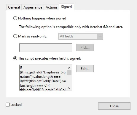

I have this script running in both the signature field and the date field. Here is the location of the signature field script:

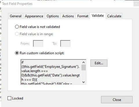

and here is where I have it for the date field:
 My script doesn't appear to have any errors, I've tested it, but is it missing something? Or am I putting the script in the wrong place?
Correct answer staceym73714452
Remove the script from the signature field. Use the one I provided as the calculation script of the date field.

try67
December 9, 2020
In the latter, change this line:
this.getField("Date").value
To:
event.value

try67
December 10, 2020
No, that's not what I said. The version with event.value should only be used under the text field.
