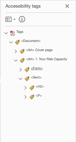

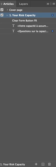

I added a long table (that overflows to a 2nd page) to my Articles panel, thinking it will be read in Acrobat. Unfortunately, the whole table doesn't show at all. Even if I tag it manually using the Accessibility feature (Reading Order), that doesn't work. What could I possibly be doing wrong?
The table should come after the <Sect> and unfortunately, it isn't there.

Hi @cmvarga5,
Hope you are doing well. Thanks for writing in!
In the tags panel, I couldn't see a tag labeled as table. Would you mind pointing it out to me?
Also, sharing the PDF file with me here would be helpful to test in-house.
But again, if you see the tag, you can right-click on it to get to the reading order panel-> then drag the table above the rest of the layers you need Acrobat to follow through should work.
For more info, visit this link: Reading Order tool for PDFs (Adobe Acrobat Pro)
Let me know if this helps.
-Souvik

Hello! That is the problem, the table isn't showing up in the Tags Panel. In the Articles panel in inDesign, it is "Questions sur la...". The table flows into the next page. But once I export to Interactive PDF, it isn't anywhere in the Tags panel.

@cmvarga5 Can you manually draw around the table and label it as a table tag?
Once that is done, check again to see if you have experienced a similar issue.
You can refer to the Correct Table Tag section in the given link: Edit document structure with the Content and Tags panels (Adobe Acrobat Pro)
