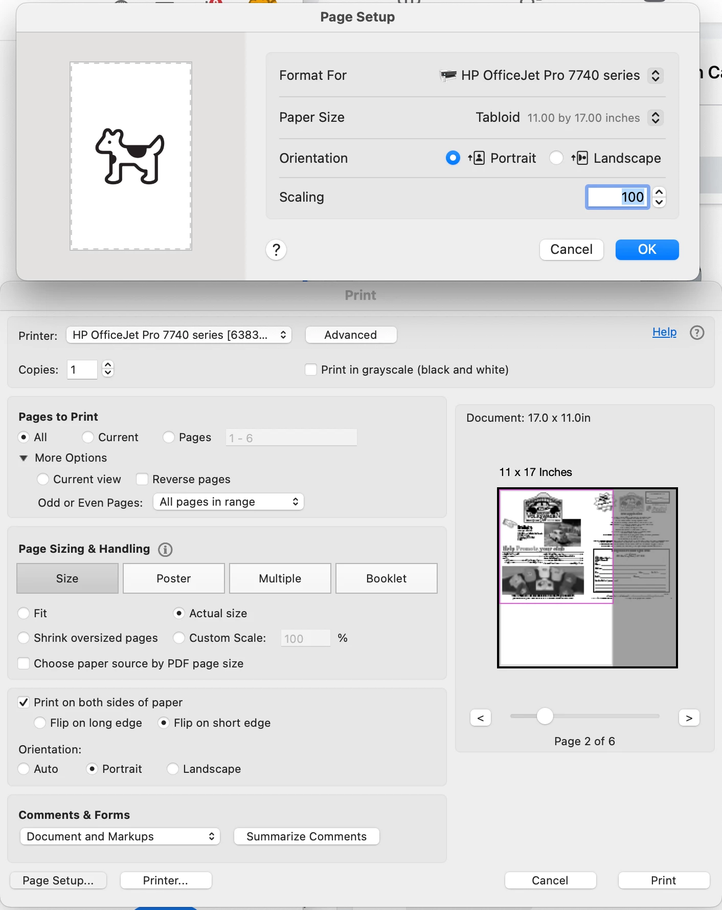

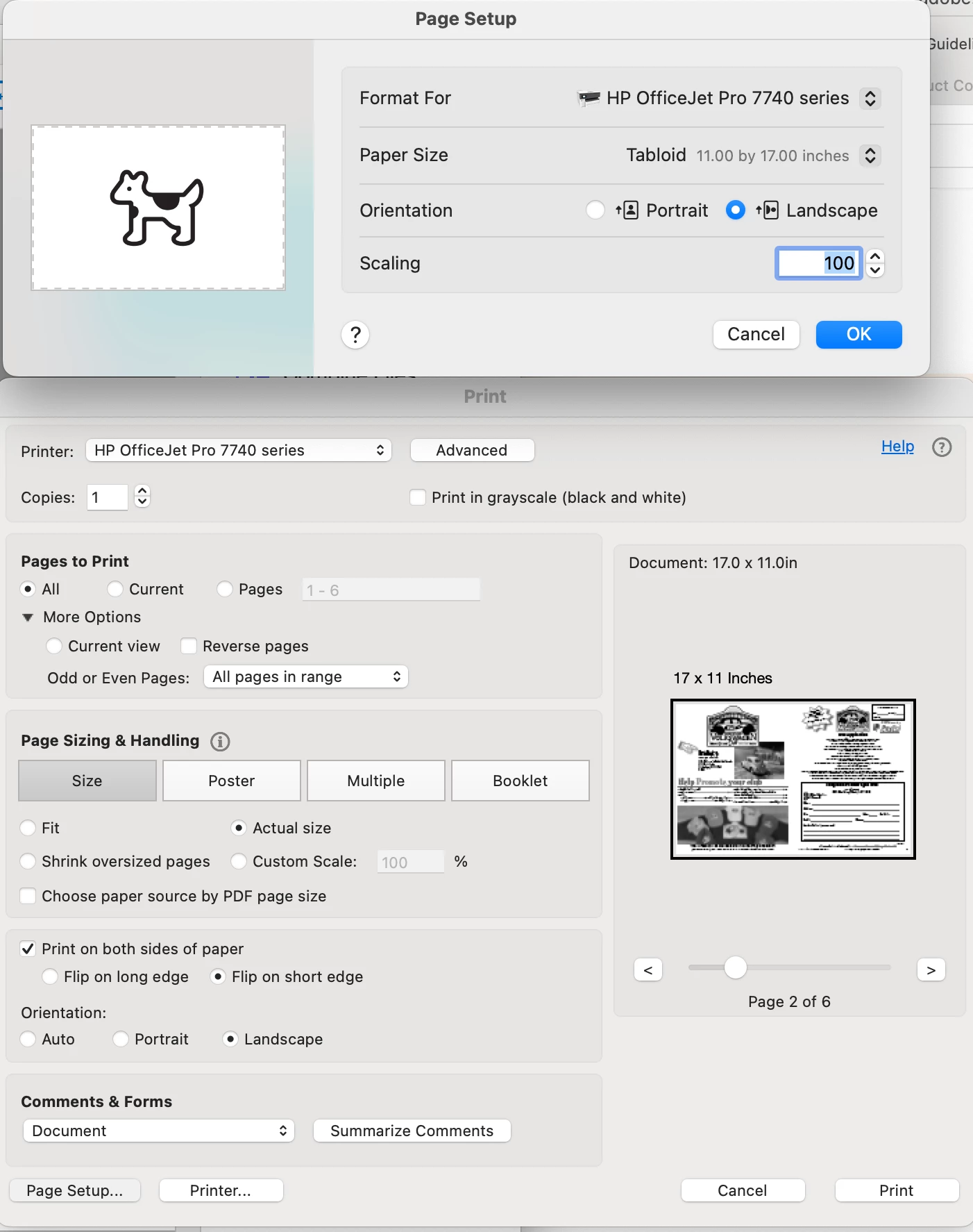

@mariajean personally, I wouldn't 'flip on short side' — If you want a newsletter (like a book), you should be using Portrait orientation. However, the screenshot shows the Landscape icon is selected in the Page Setup dialog (upper screenshot). Honestly, if you set the orientation to Portrait in both the Page Setup and the Print Dialog, the "Flip on short edge" command should work correctly.

Hi @creative explorer and thank you for taking the time to respond. Unless I'm missing something, I don't see how either 'flip on short side' or "set the orientation to Portrait" could work, I've attached an updated print dialog screen capture with those settings to visually clarify.
My Acrobat document consists of 17" x 11" pages created by printing 2, 8.5" x 11" InDesign pages as spreads. Nothing "portrait" about the resulting Acrobat page.  If my original settings were incorrect then manually rotating the 17" x 11" side 2 pages 180º in the Acrobat file would not have worked, right? Also, this has worked for me for the last 5-6 years. When troubleshooting hardware and software I always try to look at  what is has changed first and not what has stayed constant. That said, my "technique" for accomplishing the job has not changed but my hardware and software has. 1 additional point is that I'm not exacty sure what manages the "flip" function, my printer or Acrobat… Hope this clarifies and look forward to your reply as I would like to get to the bottom of this before the next newsletter in January. I believe this is a bug.
