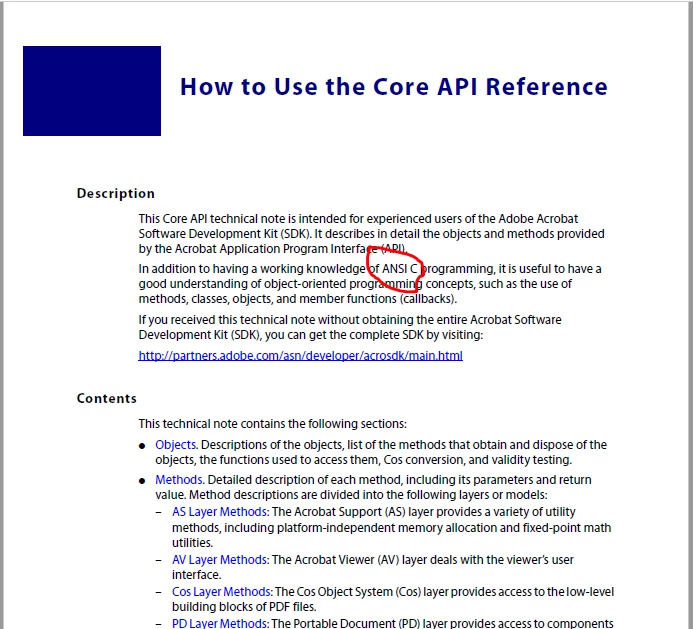

Surely there's a totally reliable way of doing this.  I've heard of a product called SiteImprove which can tell if a PDF is tagged.  How does it know?  And when a screen reader like JAWS reads a PDF, it reads the tag tree.  How does it do it?  There's an API that can be exploited for such things.  All you need is a language like C to access it.

The Acrobat SDK exposes a C++ API for plug-ins that can walk through the objects actually within a PDF. It cannot be used to make standalone apps, on a server, or via scripting. Knowledge of the PDF specification is a must.

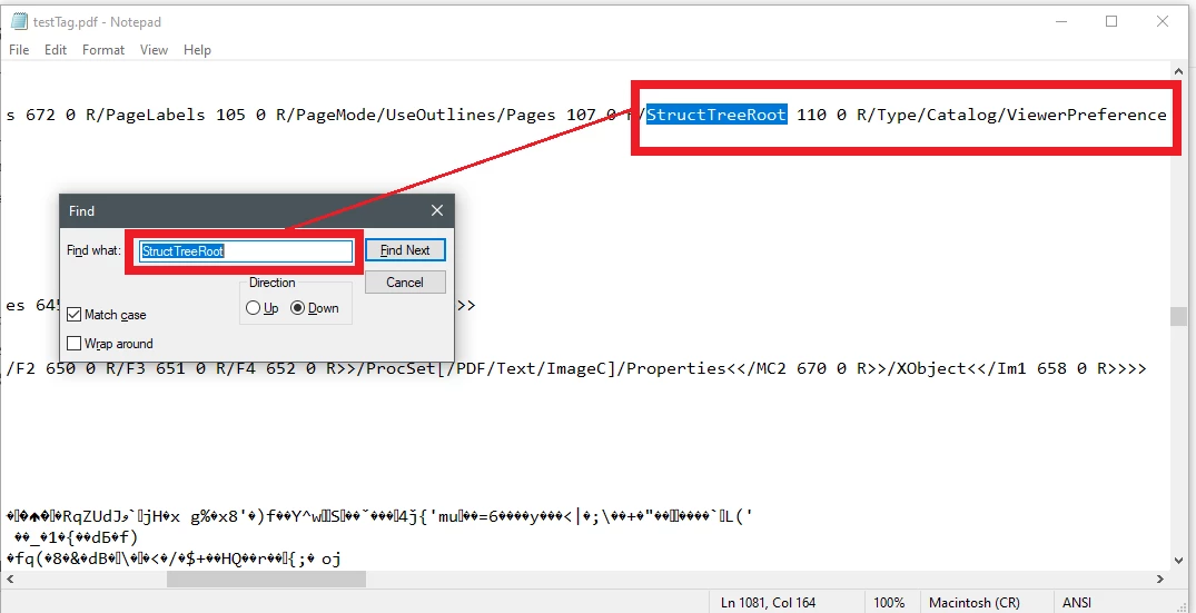

Anyway, if you open a PDF that you know is tagged using a file text editor (such as Microsoft's Notepad (if on MS Windows), or Notepad++, and TextEdit (if on a macOS)), you would want to empasize in your batch script to look for the string of the "StructTreeRoot" element (or property).
So, just for testing purposes, if you open a PDF with a text editor and perform a search for the  "StructTreeRoot" string pattern,  then chances are that the PDF document is tagged; and that is due to the presence of the StructTreeRoot catalog in those files. See screenshot:

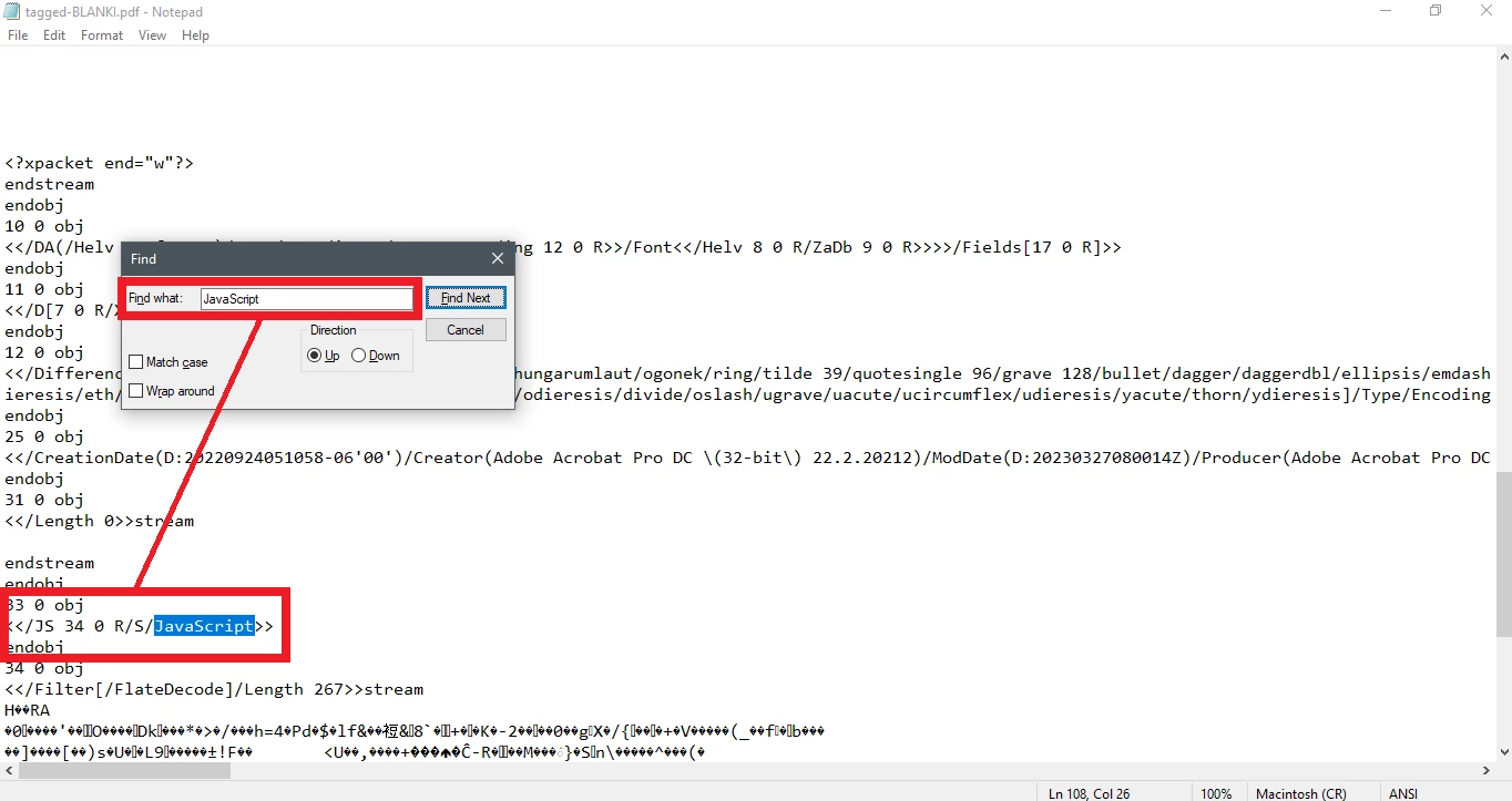

You may test with another file using the same method above to search for the "JavaScript" string pattern; if the PDF has JavaScript scripts on it, the search will highlight such text string indicating that one or more JavaScript object(s) are in use with that file.
