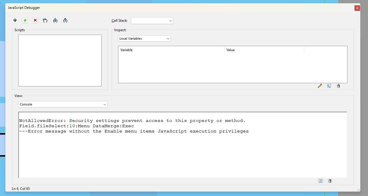

Feb 20, 2025 3:38 PM UTC
"it works flawlessly on Windows OS"
I don't see how it can since the function is not a trusted function.  You have two methods that require a privileged context:
1)  Setting the field fileSelect flag
2) doc.importTextData when the cPath is specified.
Feb 20, 2025 4:45 PM UTC
I have thought about that but it works when you check the Enable menu items JavaScript execution privileges in the Preferences.
When you check that, it does not require Privileged context. I have tried it on multiple machines.
Also, the console would mentiontion this:
I will post a new reply at the top. I have some more information from that person.
PDF Automation Station
Feb 20, 2025 4:53 PM UTC
Oh, that's what that's for. ☺
