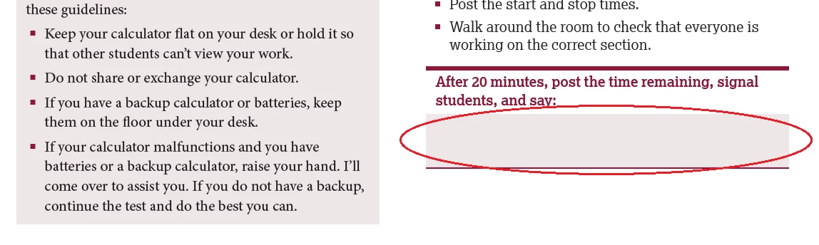

When we change Reading order for Accessibility process using "Order" option in Acrobat Professional XI version, the text was hidden, how we can avoid this issue in future, is this known bug in Acrobat?
This is Accessibility PDF creation process. We are facing this issue when change reading order in pdf. Is there any possiblity to avoid text hidden issue, is it manual process if text hidden in pdf we should go and use "Bring to front" option to show the hidden text. Sometime our user missed to do it and customer complaint also receiving for this text hidden issue. Could you please solve or advice.
Note: Source is PDF, we dont have any application file like InDesign. Input is PDF and output is Accessible PDF

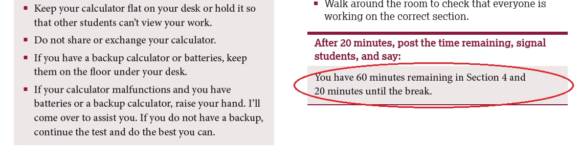

Input:
Output:

@jonathanw22774588 and @Jayesh_Kumar@int, this is caused by incorrect control of the stacking order in Adobe InDesign and can be prevented by better construction methods in the original source layout file.
In the original sample that is posted above, the light gray background box is a separate element from the text. When the architectural order was changed in the PDF (I'm assuming that elements were moved up/down in the order tree), the background box ended up above the text and now hides it. The text hasn't been removed, just covered by the gray box.
The best method is to prevent this from happening at all by using better techniques in InDesign. But that's for another day or class.
If all you have is the PDF, you can remediate the file and unhide the text by using the Content Panel, which shows every element on the page. Locate the element for the background box, it's usually a Path and should be artifacted. Slide it up or down in the tree until it's now out of the way and lets the text show again. Since it's a decorative background box, it really doesn't matter where it ends up in the tree because it's artifacted.
