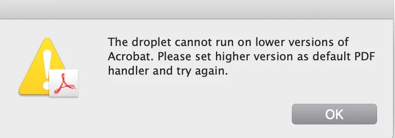

The dropblet cannot run on lower versions of Acrobat. Please set higher version as default handler.
Hi there,
I had some droplets created by a previous person that were on my older Mac system (Yosemite) that utilized Acrobat to process PDF files.
When I transferred over those droplets to my new machine (Currently on Catalina 10.15.7) they won't work anymore.  I cannot, for the life of me figure out what the issue is.  I tried zipping the droplets before transferring to the new machine, but that didn't work.
When I try to use them, the error I get is:
"The droplet cannot run on lower versions of Acrobat. Please set higher version as default PDF handler and try again."
But my Acrobat is up to date to the latest version I can upgrade to, and the old machine potentially had the same version of Acrobat, so I'm very confused.
I also know that you can change your OS's preferred PDF application by getting info on a PDF file and changing it to Acrobat.  I've done this already.
I'm running Acrobat DC 2021.005.20048.
Here is one of the droplets (because this forum won't let me attach the file):
https://www.dropbox.com/sh/2ki64dn3wsffnon/AAAr0aIUdAM4bte3Tv3ih5Zba?dl=0
I was thinking it has something to do with the applescript in the main.scpt file, but it refers to Acrobat as "Adobe Acrobat".  I don't believe that is the issue, as I've looked up the Acrobat applescript library, and it seems this is how you refer to the application.
I have an employee who went through the same upgrade, but the only difference is he used migration transfer to move to his new machine, and I did not.  His droplets work.  He is on the exact same OS, and Acrobat version that I'm on.
Maybe there is something in the system preferences files that needs to be fixed?
Any suggestions would be greatly appreciated!

Jun 30, 2021 3:34 PM UTC
Sorry about that!  I moved the file by accident.  Here is the file:
https://www.dropbox.com/s/5vg46e3766sdcod/00-00-Black.zip?dl=0
I zipped this.  When unzipped it become an application.
Here is the error I get:
Thanks!
