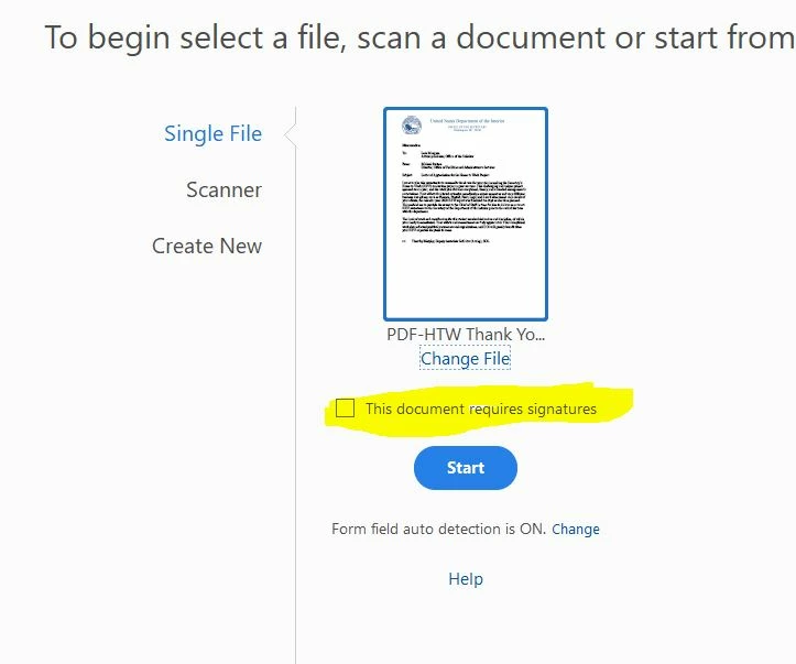

I need to add a signature block for someone else to digital sign it and for some reason is not working. When I am adding the box on "Edit"" mode I can see the box. When I preview it, it does not show. I know I can go ahead and add a border to it but still the person can't sign. I need the gray box to appear where it has a red symbol indicating to sign here and they can sign digital. I uploaded three screenshots to explain what's going on. The first one is how it appear when I am adding the signature box, the second one is how it looks when I preview it ( blank- nothing shows), and the third one is what I am looking for. Any help? Thanks

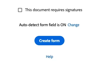

Where did this option for a signature block go?  My computer updated Adobe again and now this field is gone.  How are we supposed to create a document with a signature field?  The signature block does not work because when you type into it it does not take you to adding your certified signature.  It just lets you type into it.

 I have the same baffling issue - I did find when I DID NOT CLICK The "This Document require Signature" check box. The signature field buttons were available and the red signature flag appears.    Another issue is when you link the PDF in Constant Contact email - the signature function disappears for some users, even if download.  This unpredictablity is really bad for business on multiple levels.

Looking at the first 2 pictures, I guess you are applying a simple text filed for signature and that is the reason it looks blank.
Have you selected Prepare form>Add Digital signature (from menu bar at the top)? If not, then try that.
This will bring the "Sign here" dialog box as showed in last image.

I appreciate you responding back to me. I notice what was going on. When I select "Prepare a Form", I was checking the box "This form requires a signature" (which is exactly what I need) and the opton that I needed didn't appear.  What I need is to create a box for another user to be able to sign it. Checking the check box "This form requires a signature, I think is for the creator to create a signature. It was a bit misleading on how to request a signature. By unchecking the box, I was able to add the box that has the red flag for someone to make a digital signature. Thank you

Your observation is absolutely correct. That option is needs to be checked if you (sender) would like to sign the document too.
