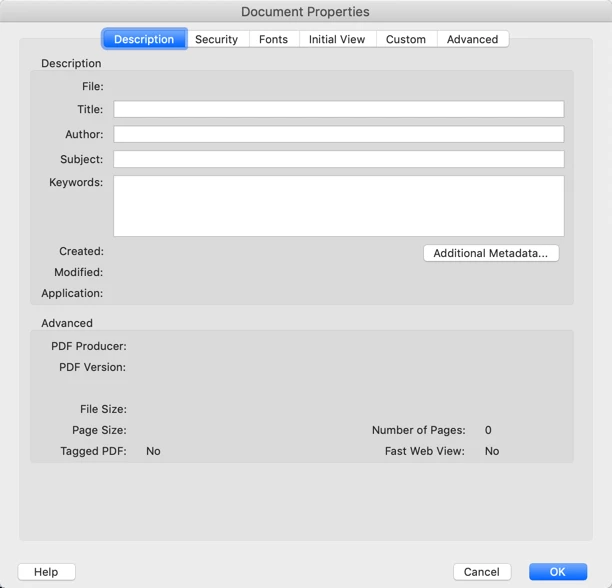

Any time you see this error message, there is a pretty good chance that your file is actually corrupt. I personally have never seen an instance when this message was in error. This means that your file has a problem. You can find out more about the problem by holding down the Control key when you acknowledge the message. With the attached file, I am getting "Unterminated string". When I try to scan for syntax problems with the preflight tool in Acrobat DC Pro, it cannot even get to the point to find syntax areas, it bails out with this error before anything can be reported:
If you can work around this problem by "refrying" the PDF (that's what we call the saving of a PDF file to PDF), then that is very likely your only option. You may want to find out why this file (and similar files) are corrupt. I would blame the generating application. When I look at the document inforamtion I get this:
The lack of information here is not a good sign: Whatever application created this PDF file is trying to hide what application that was. Based on my experience, this is not a good sign, and points to software that usually is low quality.
