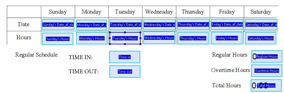

Nov 13, 2020 2:30 PM UTC
How would I make a calculation if i need the regular hours and overtime hours and total hours but i don't have time in and time out for each day, i only have the total number of hours per day.
Nov 13, 2020 2:31 PM UTC
try67
Nov 13, 2020 4:13 PM UTC
What's the formula for regular time v. overtime, then?

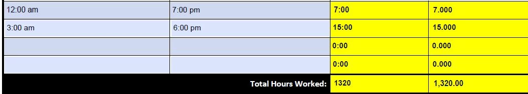

Jun 15, 2018 3:01 AM UTC
Good Evening gkaiseril,
If I have multiple "Total Time Worked" field how can I tally and them together? Also, how do I keep the same formatting?
Thank you
