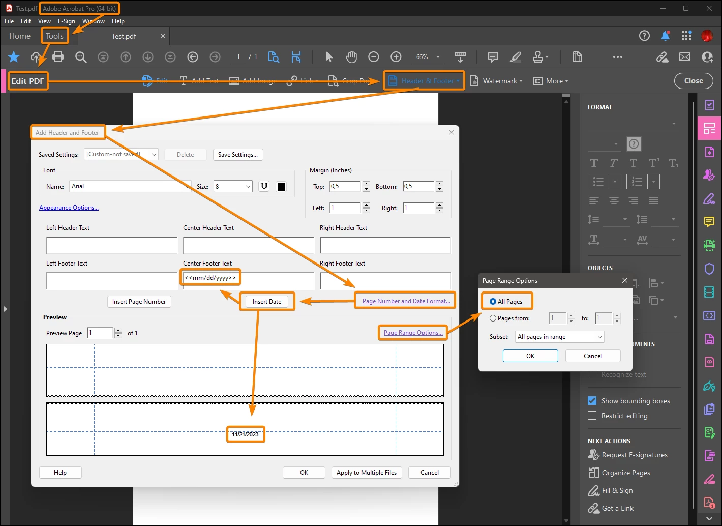

JR Boulay
November 21, 2023
Other users must have Acrobat Pro to be able to edit Header & Footer.
You can restrict document modification without prohibiting comments.
InezSAuthor
November 22, 2023
Thank you, but did want to set a password.  Sometimes the things we want to achieve may not be possible and this just may be one of those things.  No password because there can possible be many users.  Thanks for the suggestions.
JR Boulay
November 21, 2023
Fortunately, you don't need JavaScript nor form fields to add a date to every page.
That's what the Header & Footer function is for, and it allows easy updates.
