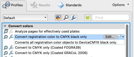

Hi @Jordan_Garren7838 ,
Can you share more details about the expectation and requirement here? Does this existing fixup not solve the problem ?
You can also refer : https://helpx.adobe.com/in/acrobat/using/correcting-problem-areas-preflight-tool.html for any help around how to edit or create custom fixup.
