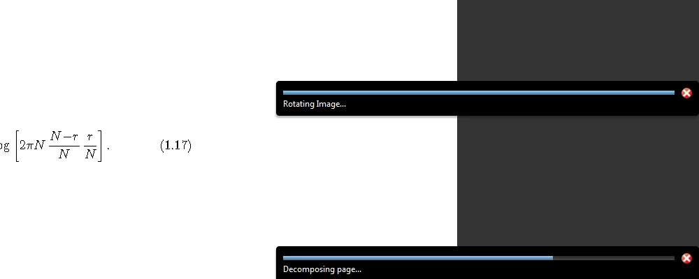

Does anyone know how I turn off this feature in Adobe Acrobat 9.0 and/or Adobe Reader? When i use Acrobat (and Reader for that matter) on my own notebook (Vista w/ SP1), I get this message all the time when I open a new PDF. The message also appears when I scroll in an open document, and this slows down Acrobat a lot. And it makes me think of switching to another PDF-viewer..
I've attached a picture with two of the messages that I usually get when opening/scrolling in documents.
As you understand, I find this really annoying, and specially when I know it is possible to disable this feature. On the computer labs at the university, they got the same software (and the same setup), but when I open the same document on those computers, I never experience this "problem". So my conclusion is that it is possible to disable this feature, and just open new documents and scroll how much as I want without having to wait for Adobe to rotate pages, deskew images, etc..

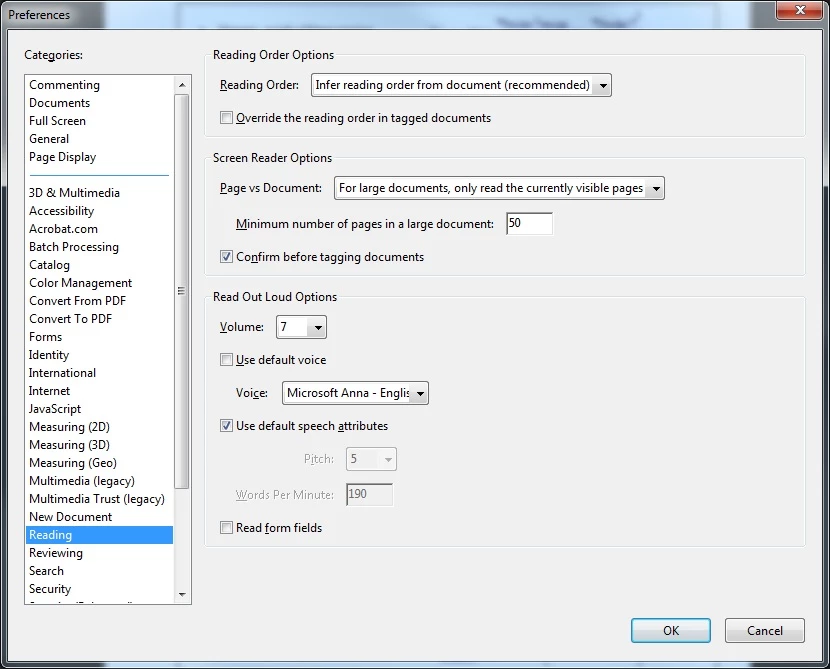

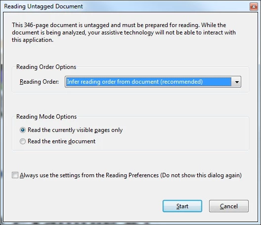

    You need to turn off the Reading Document to avoid this annoying thing. To do that:
    go to Edit->Preferences, then in the Categories click on "Reading", then check the "Confirm before tagging documents". Then when you start the Acrobat next time (open a documents), you will be asked about reading, you press "Cancel", and it will not try to do that stupid stuff again.
    Be careful, if you check Always use the setting..., then it overwrites the previous ckeck, and starts the annoying stuff again, but you can go through the process to stop it as I said, again.
    Above, check confirm before tagging documents
    Above, always click "Cancel"
