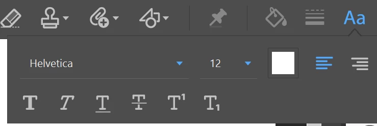

Is the type color set to white? do you see a little white box in the text properties box? If so, click on it to change it.

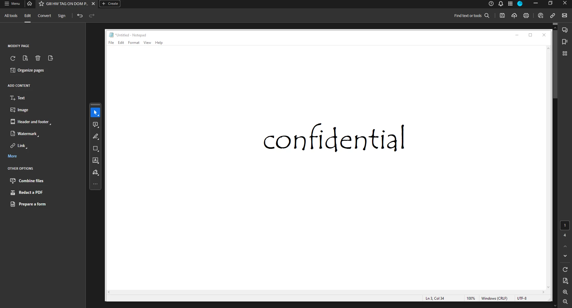

I am having a same issue with my new version of 2023.006.20320. I couldn't find the text box anywhere, please help! I always use them from the older version from the comment tab but the new does not have it. This is what my Adobe looks like...
February 18, 2019
Luke,
OMG!! I never thought to check that, and you're right, that was the issue.
I don't know how it got changed
but I'm very grateful to you for solving it.
