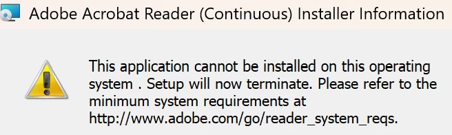

    I’ve tried all these possibilities above, but I get the following:
    I have a Samsung Galaxy Book4 Edge (Snapdragon X Elite).
    If I install from the Microsoft Store, I can read PDFs, but I’m unable to sign documents (unless I pay). Very frustrating.
    justlearn
    Sep 14, 2026 9:35 AM UTC
    ​@avid_youth0fe4 your error message essnetially is telling you the installer you're using is not compatible with the ARM version of Windows. The Microsoft Store version is designed to work on ARM devices, which is why it installs and opens PDFs successfully. As for signing, Acrobat Reader should still allow you to sign your own documents for free. Are you trying to sign the document yourself, or send it to someone else for signature? Those are different features and have different licensing requirements.
