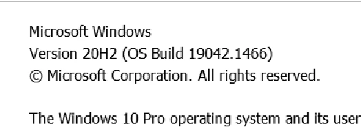

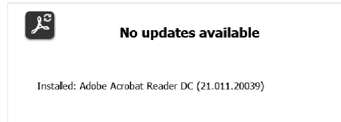

Could you please confirm the Acrobat Reader DC and OS version on the machine?
What happens when you try to print? Do you receive any error messages?

Basically, I get tickets from user saying they can print everywhere else on their computer except for adobe. I log in, hit print, sure enough, doesnt print. Go to control panel, test page prints fine, open PDF in chrome, prints fine. Uninstall adobe, restart, delete adobe folders in prog. files, prog. files x86, app data(all 3 folders in there, local roaming etc) basically nuke the entire program off the machine. I think reboot again after emptying recycle bin and reinstall. I then can print, for about a day. The main difference I notice is when printing is working(on the fresh install) there is a loading bar that goes after you hit print, and then it prints. After the 24 hours-ish of being reinstalled, it no longer does the loading bar and will not print.
This is now for 12 of my 140 apartment complex leasing offices I administrate.
