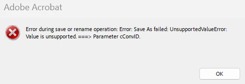

I´m trying to rename and save a fillable PDF to a different location without succes. I´m using the following javascript and getting a warning and anerror message as attached. Any suggestions?
Thank you all in advance

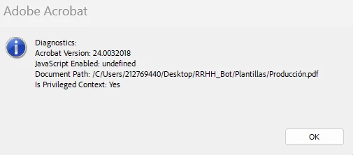

diagnostics.push("Acrobat Version: " + app.viewerVersion);
diagnostics.push("JavaScript Enabled: " + app.fs.isJavaScriptEnabled);
diagnostics.push("Document Path: " + (this.path ? this.path : "Unknown"));
diagnostics.push("Is Privileged Context: " + (app.trustedFunction ? "Yes" : "No"));
console.println("Diagnostics:\n" + diagnostics.join("\n"));
app.alert("Diagnostics:\n" + diagnostics.join("\n"), 3);

app.alert("Error during save or rename operation: " + e, 0);

Remove the cConvID. You use a wrong value for it.
