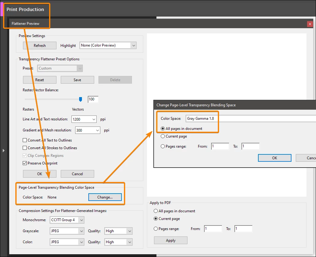

July 1, 2022
1. Yes
2. No
4. The output intent is a metadata, it will no change anything in the document.
3 :

Thank you, but unfortunately this does not work in my case.
After changing the transparency to Gray Gamma 1.8. and after flattening, some objects become calgray. They get Gray Gamma 1.8. tags and they visually "stick out" in the design in Print Preview.
I also saw some artefacts between them and the rest of the objects (in cases where they touch each other or where they partially overlap).
Whenever I notice artefacts, I turn off smoothing in Preferences>Page Display, and the problem usually goes away, but not in this case.
I think that I found a better solution, but I'm not an expert and maybe this is not a wise thing to do:
By using 3rd party plugins I attach an ICC profile to the objects. In this case it's a grayscale profile (same for all the images).
Then I change the transparency blend space to that profile (so it matches the profile of the images). After flattening, the result looks nice and all the images look uniform and they are all tagged with the same profile.
Here and there I saw some artefacts, but after turning off smoothing in Page Display, they are gone, so I assume it's safe. If necesary, in the end I can remove the ICC profile from the images.
