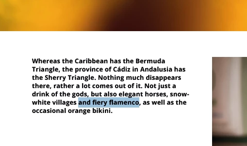

 I've been working on a PDF version of an online magazine, where I'm just exporting the webpages to PDF and framing those PDFs in an Indesign document.

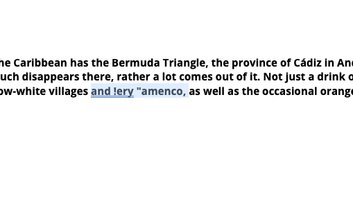

Everything looks fine in the Indesign document and when I export it to PDF everything looks fine in Acrobat too, but when I copy parts of the text from the PDF to a word document the fi, fl, fr, etc. get changed into !, ", etc. (check added files)
I've been struggling with this for a while now, but I cant seem to find an easy fix for it, since I'm not using text boxes.
Hopefully someone knows a good solution.

Ligatures are typically a feature of the font that you're using. Usually an OpenType font. If you're copying text from Acrobat and pasting into Word and the Word doc is not using an OpenType font, there's no character that can be used to recognize the ligature. I'd try choosing an OpenType font in Word before pasting the text. I'd also ask the question why you're going from InDesign to PDF to Word. Why not go directly from InDesign to Word? A lot of conversion occurs when the PDF is generated and some features will be lost.
October 30, 2020
Hmm I've tried for a while, but that doesn't seem to work sadly.
Problem is that I have to send a PDF to this company I'm working with. They apparently have a very strict way of doing things, so they have to copy from PDF to Word.
