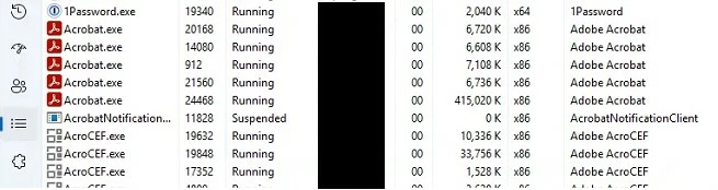

Updated Acrobat to Sep 3rd update 25.001.20672 and now Acrobat will freeze when opening PDFS
Running into an issue this morning with Acrobat where the latest update is causing more freezing and locking up. Looks like Acrobat.exe is not closing out completely when closing a pdf. The more pdfs that are opened, the more freezing occurs as adobe is staying open in the background
Tried a repair and that didn't fix it, so for now I have uninstalled and installed an older version where the issue does not occur
