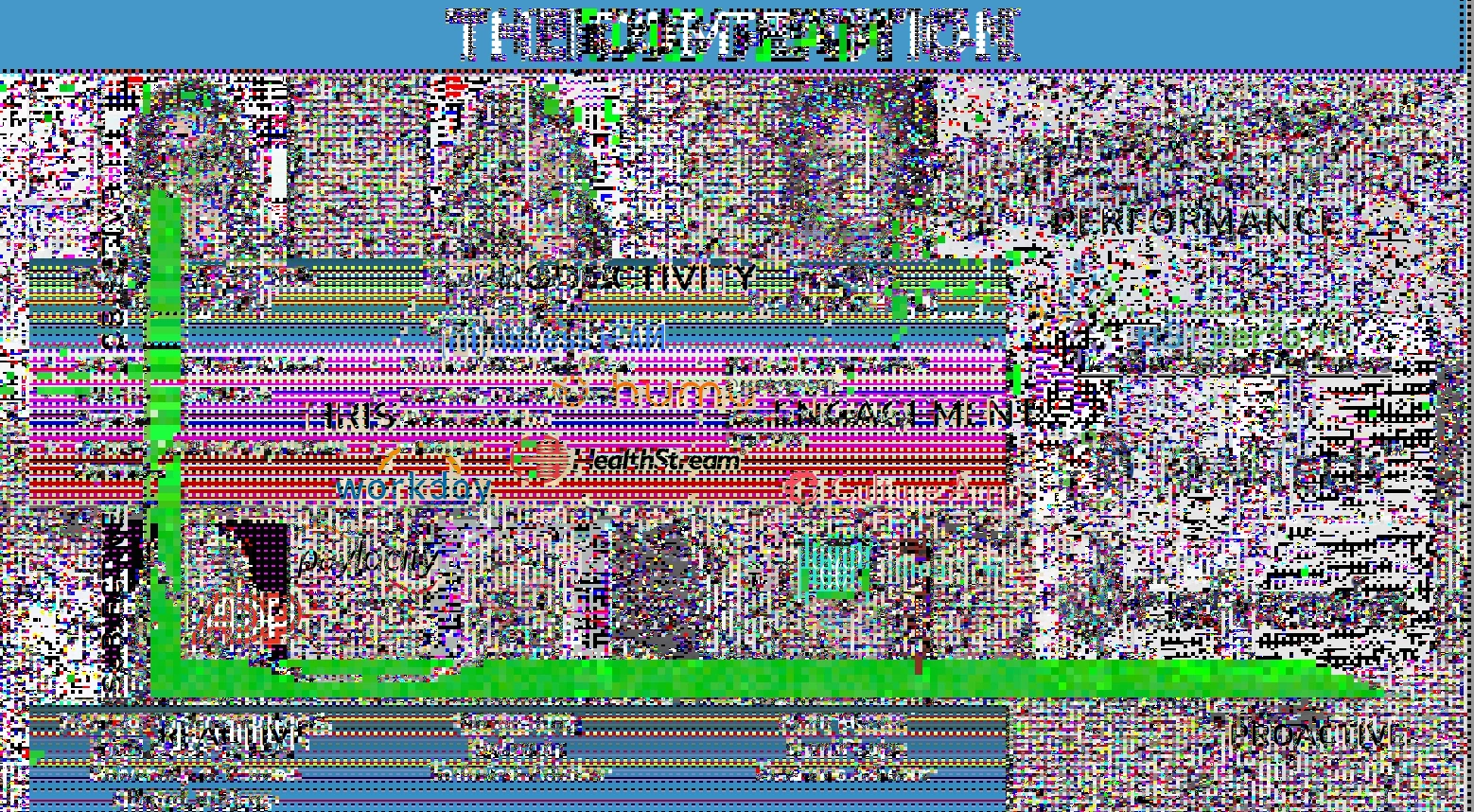

I seem to be having a similar problem. I have tried every solution, but also haven't seen a screenshot similar to my problem. I attached a screenshot. Yes, the ctrl-f and selecting a letter "a" does seem to temporarily fix that page. But there has to be a better solution. Thank you!!!
July 8, 2020
For some reason, pressing Ctrl + F (so essentially the find function), and then closing the find input box works.

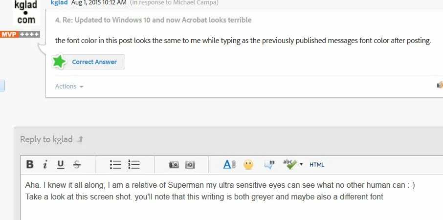

BTW, there is one thing you can check now. It seems that what I am writing now is greyer than your posts and my question above. This may change once I publish this reply, but you may want to notice if this happens to you too.
      Addendum:  Once I published it it did become the same black so it would be interesting to know why it is grey when you are writing and black when you are reading.

the font color in this post looks the same to me while typing as the previously published messages font color after posting.

Aha. I knew it all along, I am a relative of Superman my ultra sensitive eyes can see what no other human can :-)
Take a look at this screen shot. you'll note that this writing is both greyer and maybe also a different font (oh and I;m not on my lap top now)
My writing, shown on the image above is actually bigger then what you see here. If u'r in the mood for it and eel like downloading the image see if what I say is right.
