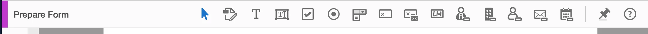

Thank you that helps to know what to do once I get the correct field type. This is the icon/feature that doesn't seem to be available to me, one I see in tutorials. I don't see the option to add a "button" or "image" field. Attached is a screenshot with the field icons I have. None see to accommodate a button. Does the new Acrobat call it something else?
Click on Tools - Prepare Form and then click on "More" at the right side of the window and then on "Revert to Acrobat Form". In the future, do not tick the box that says "This document requires signatures" when creating the form.

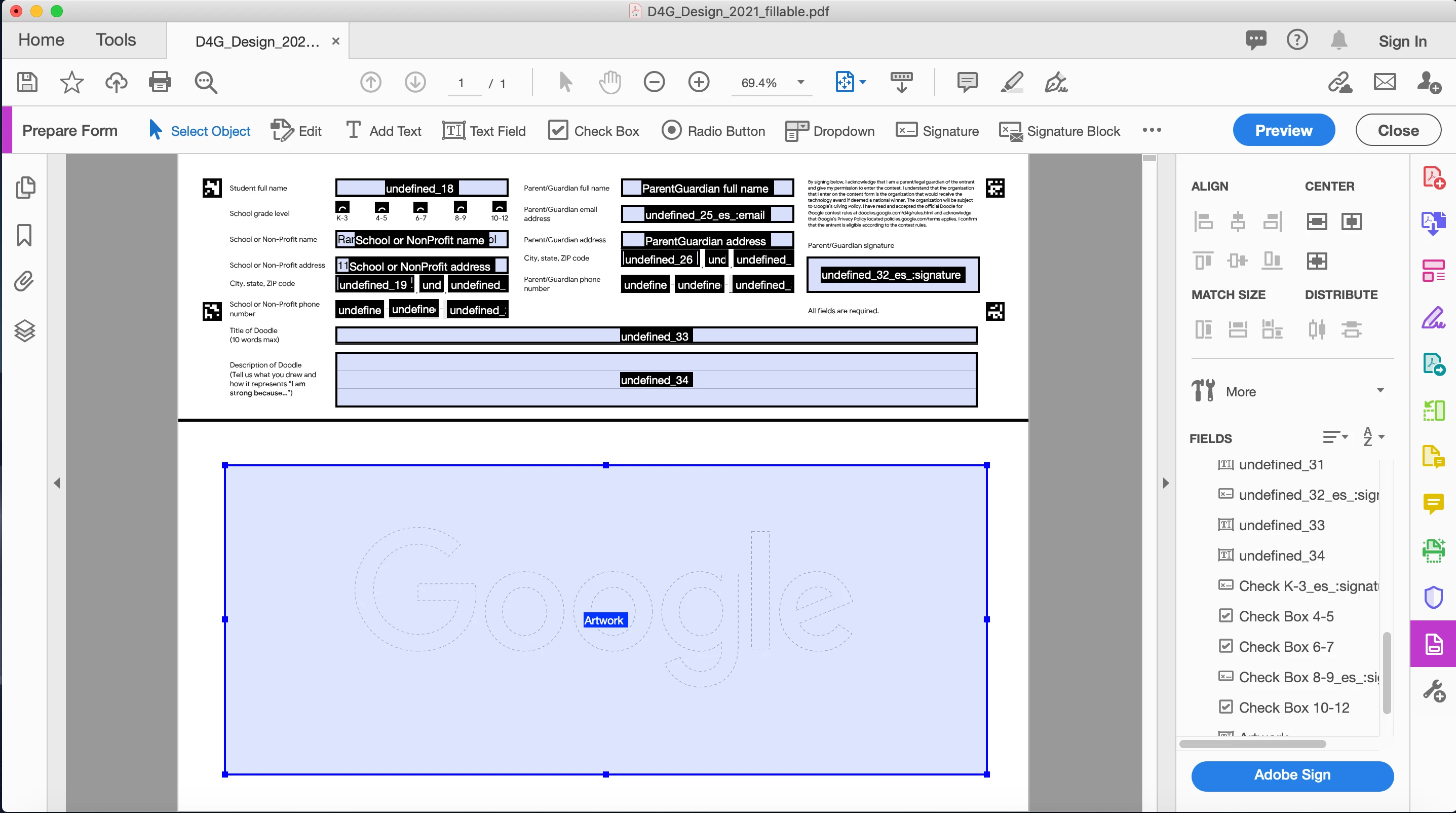

The box I would like to make an image file is the large box at the bottom title "artwork". Any help is much appreciated.
