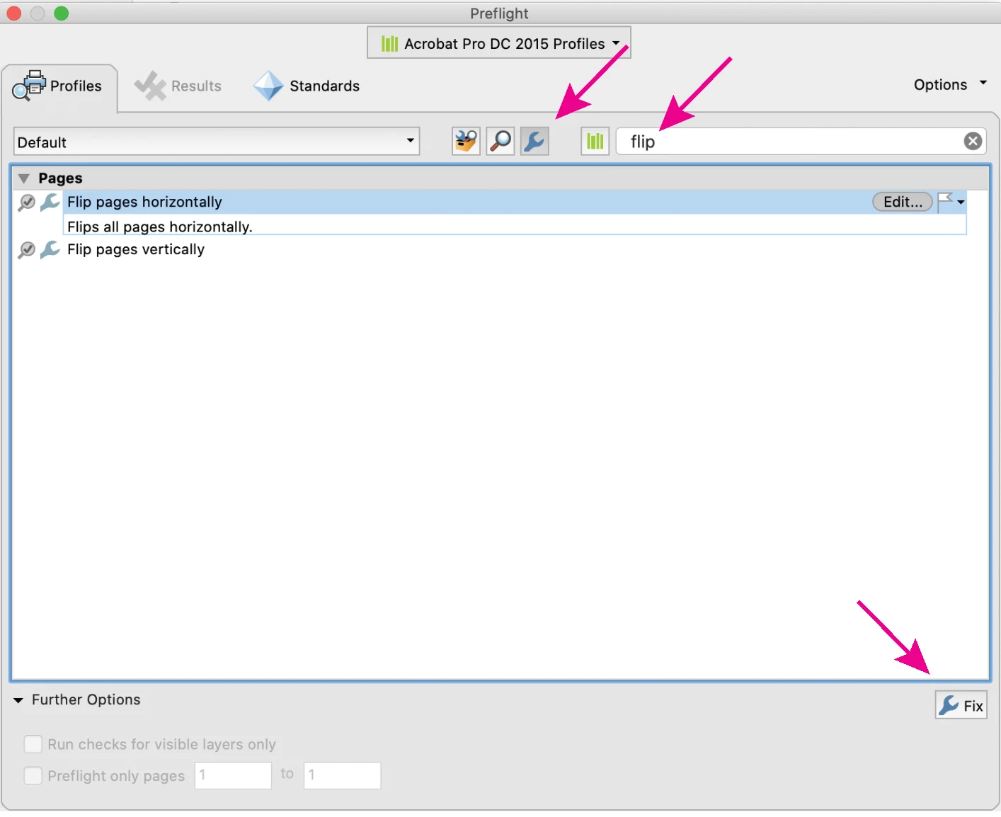

I'm an origami artist working on an incredibly complicated model (Ryujin 3.5 to be more specific). I'm using some guides for how to fold it because it's too complex for me to try and figure out on my own, however these guides are based on a version of the crease pattern (which is the map of creases that form the base model for those who don't know) which is flipped horizontally compared to the one I have. I don't want to convert it to some other format for easier transformation as the details are very fine and I can't risk losing any quality as such, so I loaded it into Acrobat, but it seems to break up the pdf into very random parts, meaning I have these pieces of the crease pattern which are freely editable independent from the rest of the file and others that I can't even select. Resultantly, flipping it is much more difficult than I'd have liked.
So my two thoughts are either to flip the entire page horizontally, or use a 'select all on page' tool (and ideally group all the objects) and flip them then. As of yet I haven't found any way to do either of those things. Any pointers?

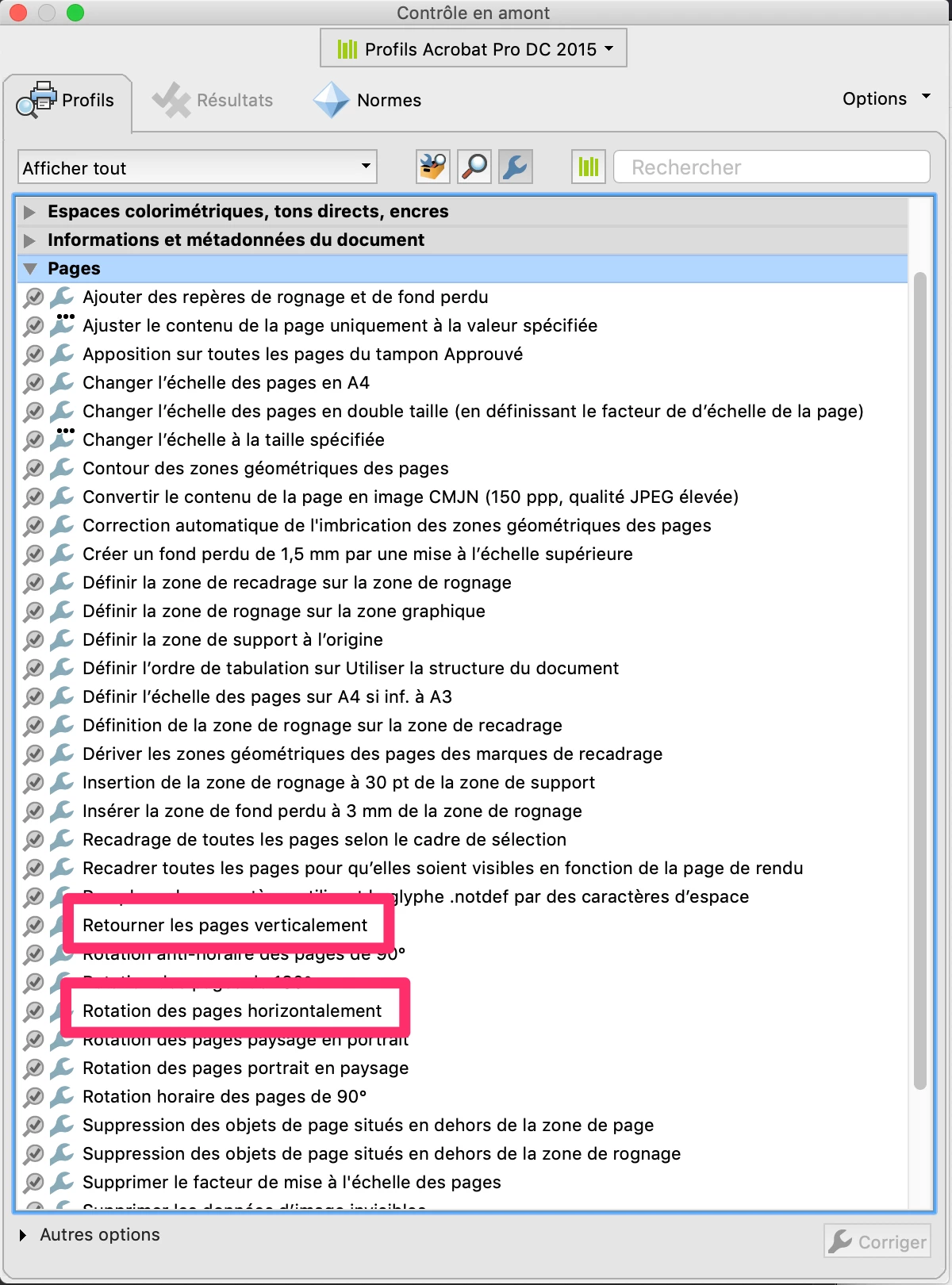

Petite note pour les francophones :
J'ai eu beaucoup de mal à trouver cette fonction lorsque j'en ai eu besoin.
Dans d'autres logiciels, Adobe utilise à raison "Miroir" pour la traduction française de "Flip". Je ne sais pour quelle raison cette traduction n'a pas également été utilisée pour Acrobat !!! Le pire étant que la traduction n'est pas identique pour le Miroir horizontal (traduit par "Rotation des pages horizontalement") et le Miroir vertical (traduit par "Retourner les pages verticalement").

You can do this with a preflight fixup- Tools> Print Production> Preflight> Fixup.
Would love to see a pic of the final folded piece!
