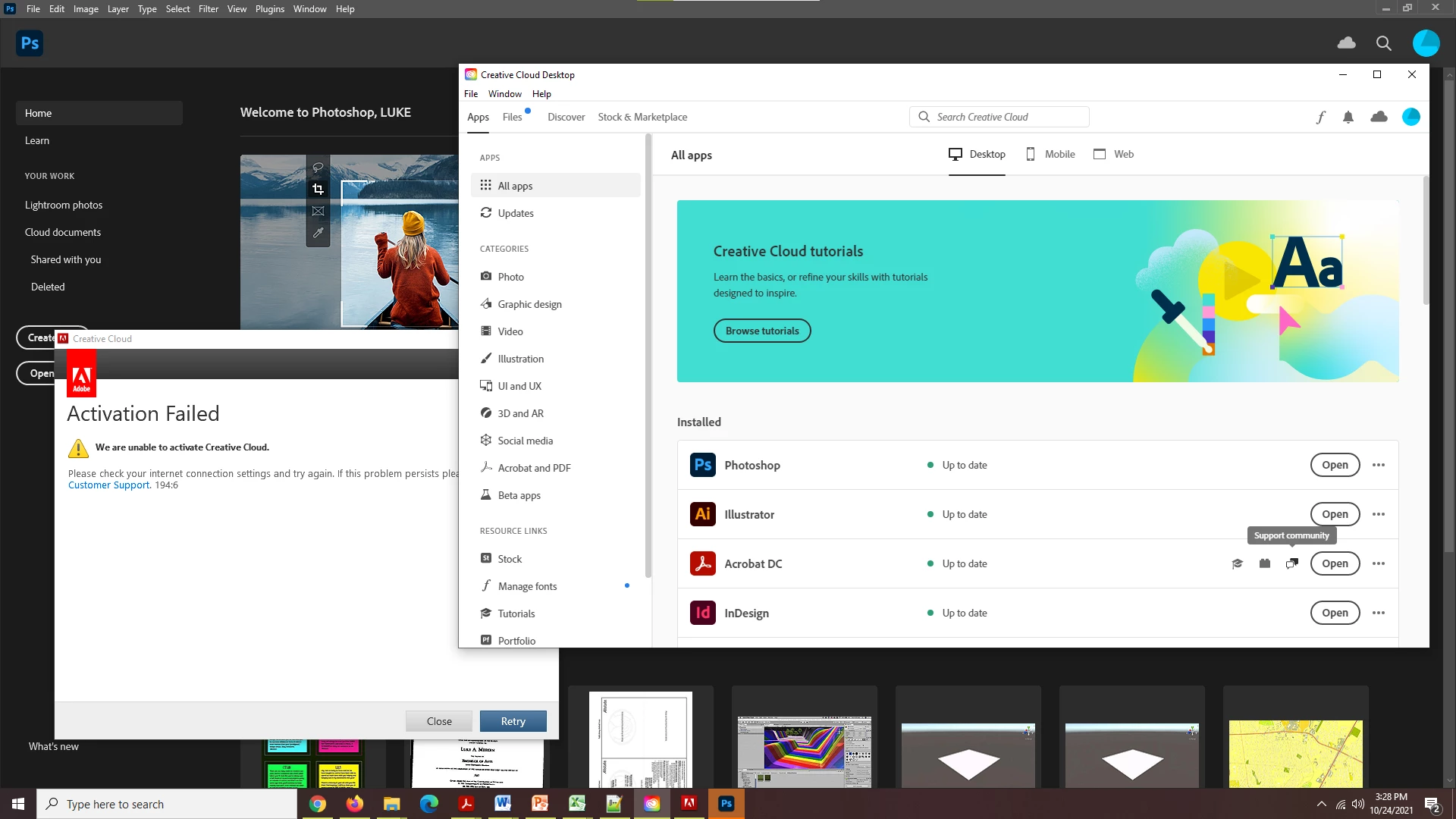

Hi. I have CC activated through my university, and have had no issues running the various programs on my personal device. However, all of a sudden, Acrobat Pro will not open. I literally was working on it one minute, closed it, and the next minute, received an error 194:6, stating "We are unable to activate creative cloud."
As you can see in the below screenshot, I am logged in to Creative Cloud just fine, and can open other apps like Photoshop. Only Acrobat is generating this error.

Hi there
Hope you are doing well and sorry to hear that.  Please try to remove the application using the Acribat Cleaner tool https://www.adobe.com/devnet-docs/acrobatetk/tools/Labs/cleaner.html  , reboot the computer and reinstall the application usin the link https://helpx.adobe.com/acrobat/kb/acrobat-dc-downloads.html and see if that works.

My first advice would be to reboot the machine.
LUKE5D50Author
October 25, 2021
I rebooted a few times, and the problem persisted. I wound up "solving" the problem by completely uninstalling and reinstalling Acrobat.
