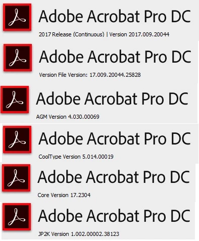

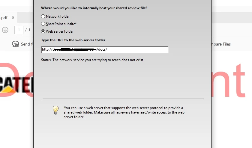

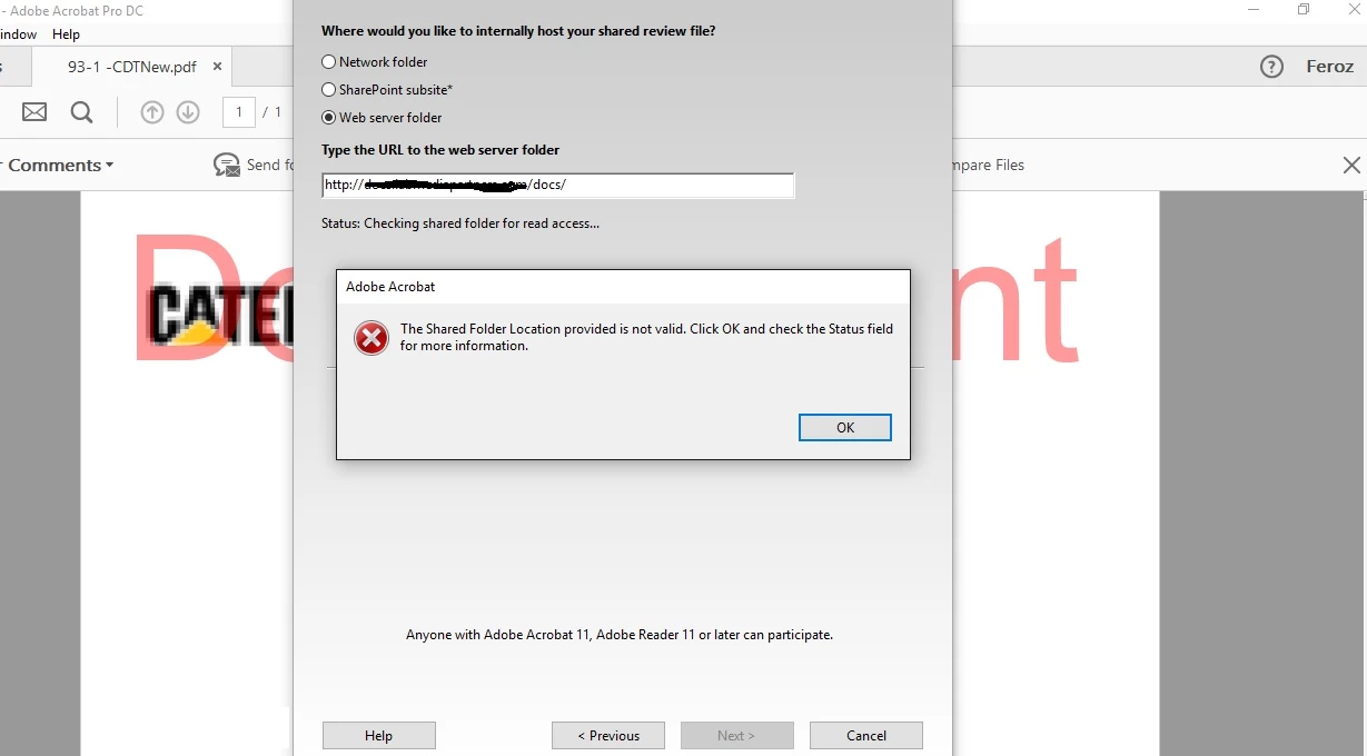

Thanks for your support. I have already tried weddav server in other browsers its working fine. I have attached the screen shots of error for your reference as well as latest version names. Also please let us know does the new Pro DC requires any authentication as must in webDav server?.

Yes,  Pro DC requires authentication until you kill the process "Adobe Collaboration Synchronizer" and delete a registry entry "CredentialsV4" under HKCU.
Could you please try the steps-
  -Kill the process "Adobe Collaboration Synchronizer" from Task Manager
  -Delete the registry entry "CredentialsV4" if present at [HKEY_CURRENT_USER\SOFTWARE\Adobe\Adobe Synchronizer\DC\CredentialsV4] , ignore if not present.
Now try the workflow. Kindly let us know how it goes.
