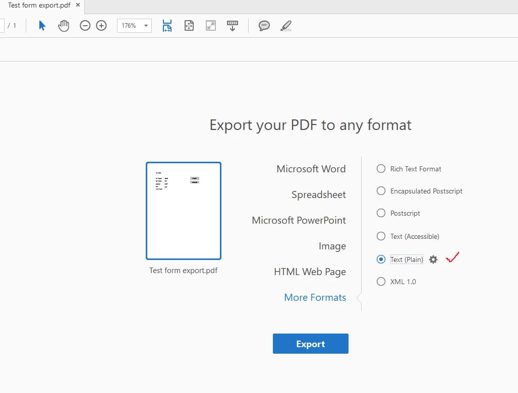

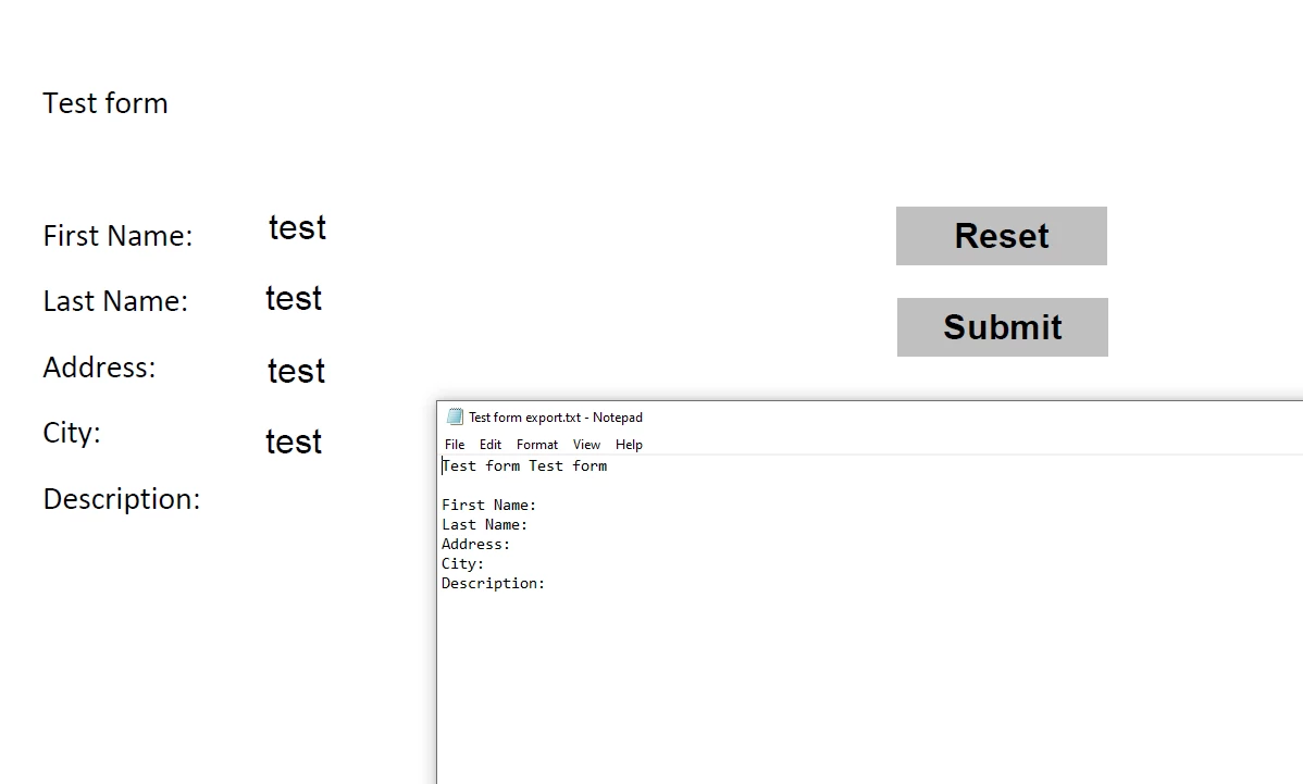

I'm using Adobe Standard 2017 and I'm trying to export the field names and corresponding data from a PDF form into a .txt file as shown in the screenshot below. The form is in the background and the txt file that is generated is in the foreground.
I'm opening the completed form then selecting More Tools > Export PDF >  More Formats (Plain Text)
The trouble is that whenever I export it, the field data does not appear. The field data appears when I export as a Word document, a spreadsheet, or an HTML file, but this particular .txt file format is what I require.

Correct answer try67
You're exporting the static contents of the file, not the form data. To do that go to Tools - Forms - More and use the Export Form Data command. Save the file as a text file and then you'll be able to open it in Excel (or even Word) to see the field names and their corresponding data.

Ah - I now see what I was doing wrong. What was confusing me is the behavior of the document when I used that export process to a Word or Excel doc, which brought the form data.
Using your method, I see I am able to use the Export Form Data command and select .txt as an option (I thought I only could do .fdf.
This process looks like it will work. Thanks for the guidance. Very much appreciated.
