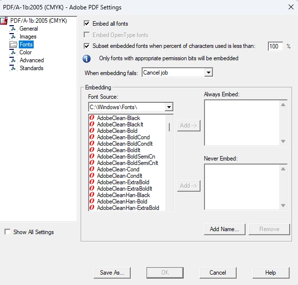

A few different aspects I would like to check when creating the PDF from MS Publisher:
1. Check Font Embedding in the PDF:
  • Problem: Some fonts or parts of a font might not be properly embedded when exporting to PDF from Publisher, which can result in inconsistent rendering or printing.
  • Solution: Make sure that fonts are fully embedded in the PDF when exporting from Publisher. Here’s how you can check and fix this:
    1. Go to File > Save As.
    2. Choose PDF in the “Save as type” dropdown.
    3. Click on the Options button.
    4. Under PDF Options, check the box for ISO 19005-1 compliant (PDF/A). This ensures all fonts are fully embedded.
2. Ensure Consistent Text Rendering:
  • Problem: The different shades or uneven spacing could be caused by variations in how Publisher handles fonts during conversion to PDF.
  • Solution: Use a Print to PDF option instead of saving directly as a PDF in Publisher. This ensures better compatibility:
    1. In Publisher, go to File > Print.
    2. Choose Adobe PDF or any other virtual PDF printer.
    3. Print the document as a PDF and then try printing the file to your physical printer.
3. Fix Uneven Line Spacing:
  • Problem: MS Publisher sometimes mishandles line spacing in exported PDFs.
  • Solution: In Publisher, ensure that all text boxes have consistent line spacing settings:
    1. Select all the text in your document.
    2. Right-click and choose Paragraph.
    3. Ensure the line spacing is uniform throughout the document before converting to PDF.
    4. You can also set the paragraph spacing to "Exactly" rather than "Auto" to prevent discrepancies.
