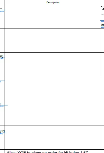

September 14, 2023
I have experienced the same issue with dissapering content. All previous descriptions are blank (see below). The fields cannot be draged or moved with the mouse once it's placed either.
