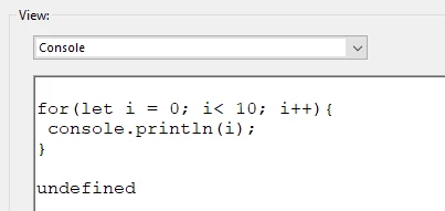

Here's a simple Javascript for-loop in Acrobat console. It works in any other console except Acrobat.
Any idea why?
I have also tried the following and still get undefined.
for(let i = 0; i < 10; i++){
 console.log(i);
Correct answer try67
Did you select the full code before executing it?

Just to add to the correct replies made above: "undefined" is not an error. The opposite, actually. It just means the code finished executing correctly, without throwing any errors or returning any values.
The issues with your code cause it to not actually do anything, but it is running.

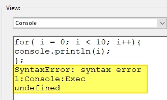

Here's the error I got.
I'm testing the script to rename all the field names in the PDF I have opened. At this point, I'm not even getting anything from the currently open PDF yet and it's giving me this error or undefined value. I have like 100 duplicate checkbox names that I want to make it unique.
try67
try67Community ExpertCorrect answer
December 23, 2021
Nesa Nurani
December 22, 2021
Use 'var' instead of 'let' and use 'println' instead of 'log'.
for(var i = 0; i < 10; i++){
console.println(i);
