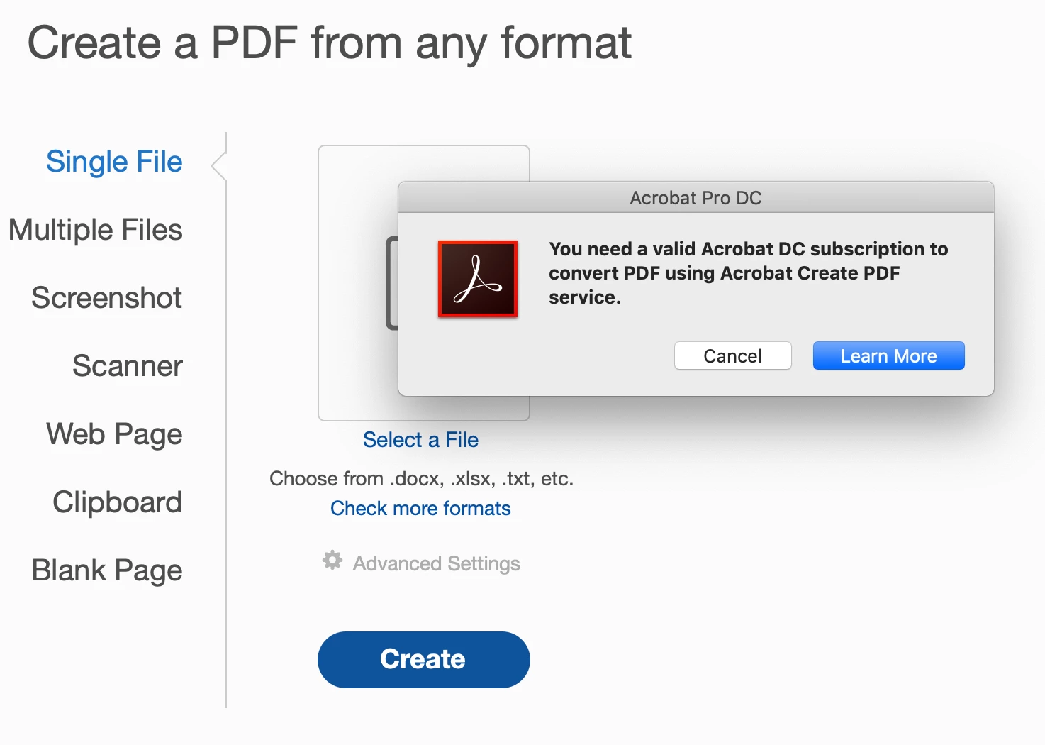

Just now I tried to create a PDF in Acrobat Pro DC by using the Create PDF button, but when I tried to open a .docx file, it said I needed a subscription which I do have. I was signed in to Acrobat Pro DC when I tried to create the PDF.

Thanks for sharing the detailed information. Unfortunately I have not received any pdf via email, so I have shared the information again via private message.
For testing purpose, can you login on Document Cloud web interface Adobe Document Cloud  and check whether you are able to create the pdf or not? Or you are getting the same message as shared above.
